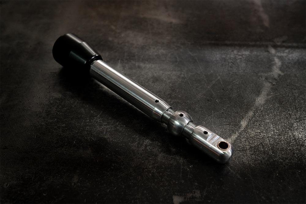

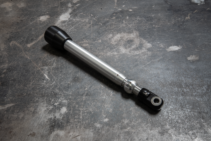

          I use Garagistics Chassis Mounted shifter. But they also have shifter that works with the oem stuff. For me this was the best bang for my buck setup.
          GARAGISTIC OEM SUPREME SHORT SHIFTER Product Description: We introduced the Solid Chassis Mounted Shifter to the community to provide an affordable race shifter that is simple to install and completely reversible. However, due to the solid mounted design, stiffer polyurethane and solid engine and transmission bushings
