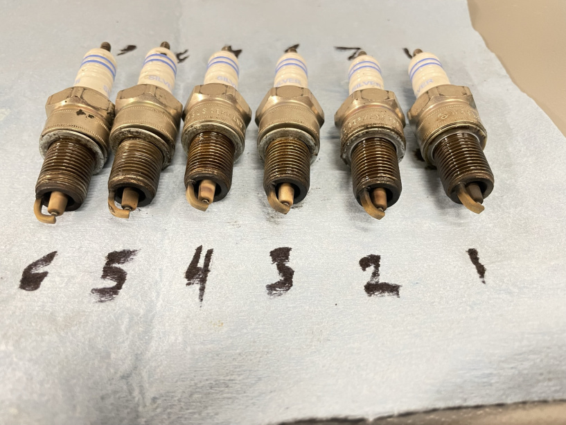

    I finally decided to take out the spark plugs and inspect them. They have some oil on the threads. Cylinder 1 actually had a decent amount of oil on it.
    Click image for larger version  Name:	IMG_8341.jpg Views:	0 Size:	192.4 KB ID:	10083658Click image for larger version  Name:	IMG_8342.jpg Views:	0 Size:	206.3 KB ID:	10083659
