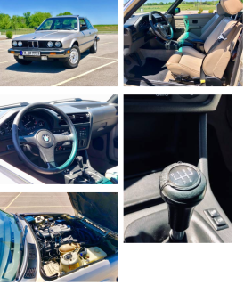

    I picked up a very well maintained 1985 325e for cheap because it has some mild hail damage. Working those dents out and painting soon. The engine (the whole car, really) are in great shape considering it has definitely been driven some miles. I even found documentation of recent timing belt replacement. Idle is pretty solid and doesn't sound tick-y, though I do plan to perform valve adjustment soon just to confirm. The only weird thing, and I don't think it is just me coming from a 335xi and 35d X5 (those are some torque monsters in comparison) is that it seems to very slightly hesitate between 2/2.5k and 3.5k. It's like it wants to go but kind of sputters or just loses power. My gut is telling me something fueling related? Any ideas where I should start? I've done quite a lot of mechanic work, but it's all unplug/unbolt/swap king of stuff and I kind of suck at troubleshooting on my own. Still learning though.
