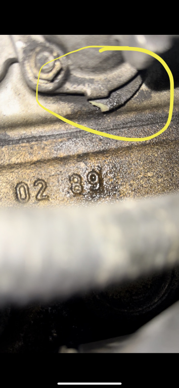

              Great news everyone, all this drama ended up just being #5 intake gasket. When searching I heard a hissing sound so I tried the starter fluid trick again under the manifold and sure enough, a fat leak. My guess is when I lifted the motor while doing the car build, I remember the straps resting against the head and moved it off after, so I believe the old neglected cracked gasket had a gap to slide thru and was literally hanging out of the intake port. You can also see oil draining out which I guess is a bit of blow by. I haven’t changed these since 2009 so this is fully my fault, so much that I had 2 packs of gaskets here just waiting. Never again
              Click image for larger version  Name:	IMG_8008.jpg Views:	0 Size:	100.8 KB ID:	10101548
