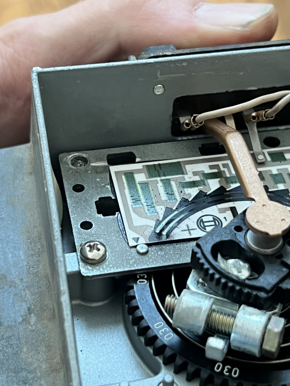

    After reading lots of threads, by first thought was afm. Also because this seems to be airflow related based on elevation and throttle. Tracks were very worn at the WOT end but adjusting the wiper to run on fresh black track didn’t fix the issue.

      Well my issue gets better (revs higher) in mountains, which makes me think it is the denser air at low elevation triggering the AFM quicker, or (now that the afm fix didn’t work) requiring more fuel at lower rpm? However it is such a hard, consistent cutoff that I still feel it is something electronic rather than fuel pressure.
