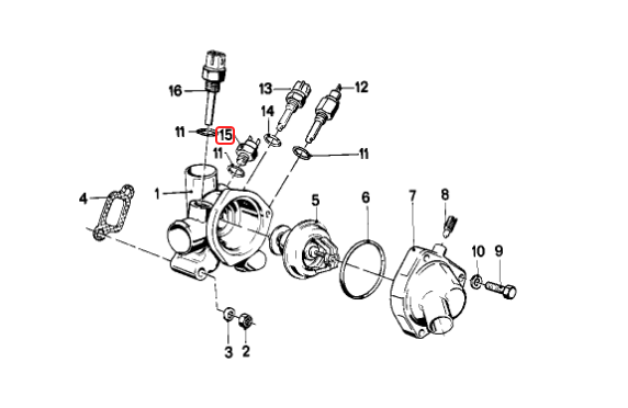

            This sort of sounds familiar to my car when it's very cold outside (+- 35f). I created this issue by bridging the wires on the temp switch (#15).When the car is cold, the switch is open, once it warms up some (not hot enough for the heater to blow warm) it closes the switch. All I have to do is drive down the road for a few minutes and it idles fine.
