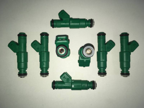

    you'll need to build the rest of the car to make use of them. pretty sure a stock car won't even run with them.
    edit : try searching for the bosch green giant injectors
    ​Genuine Bosch 42lb Green Giant EV1 BMW Chevy Camaro Ford Mustang V8 LT1 LS1 5.0L 4.6L Turbo 440cc 39lb 39.5lb Firebird Transam 0280155968 - TREperformance.com​
    there's a number of other vendors.
    you can also try looking for the ford svo or lightning bosch green top injectors. they look more like the ones found on our cars.

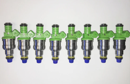

    ​Click image for larger version
    FIC Rebuilt Ford 42 LB Green Top – Spike Performance (spike-performance.com)​
    they are also all over. the first set is a more modern​ injector and it's argued to have better atomization.
