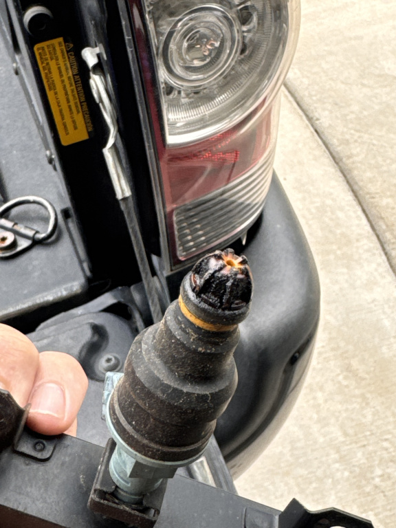

      • Injectors look really dirty to me, but the ends are clean? Was considering sending out for a rebuild or purchasing the Bosch Gen 3.

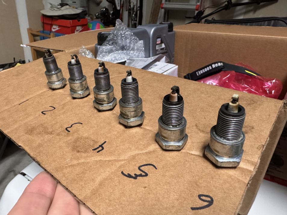

      • One of the spark plugs looks like it’s running lean, one other has fuel on it, but could entirely have been from the rail when I pulled it.
      • Spark plugs are gapped at 0.035-0.036 from box, I see spec is lower.

    Start with an injector cleaning. This generation (and earlier) is pretty sensitive to injector flow,
    and the injectors do clog- unlike later designs.

            Since I have the rail off already and it’d make me sick to put these injectors back in the car, I’m gonna send to Race German and get them flow tested and rebuilt for at least piece of mind, though I’d be sad if they tested fine before the rebuild. In any case, once they’re back if I still have issues I’ll give the ICV/DME test a try.

              i upgraded to a modern style open 4-pintle which increases efficiency, smooths idle, and helps the power curve a little. the injector tech back when the cars were built is in the stone age. mine are paired to the build and chip but there are alternatives for stock as well.

                I was messing around w "rebuilt" injectors, which means nothing outside of resealing and apparently flow matching.
                Went with the 4 pinel bosch 62415 injectors. Way better performance and way quieter too. They're new, so you wont have to think about injectors for many many miles.
