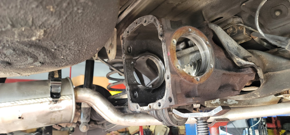

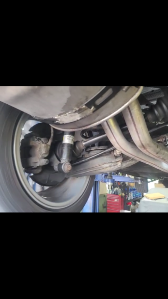

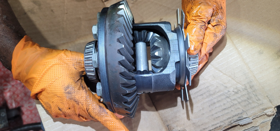

    Hello everyone. I have a 1993 325i Convertible E30, 5 speed manual. My car has a cyclical rubbing sound between 5-20 mph. It comes on while accelerating and again while coming to a stop. When it comes on it feels as though the breaks are being applied repeatedly. Took it to a local shop, BMW Surgeons, who replaced the guibo, driver’s side rear wheel bearing, removed the rear axels and took the differential apart and checked ok, tested it with different tires and wheels but the problem is still there.
    I hope that with the collective massive amount of experience and know-how there is someone here who can help solve the this puzzle. I will be eternally grateful for any thoughts on what could be causing this.
    Thank you.

            Thank you 82eye. The shop sent me a video with the car running off ground and the rear wheels appear to spin freely so if it is the rear then it is only happening under load.

                    Hello tomstin. Thanks for sticking with me. There aren’t any scuff marks on the rims, the wheel wells, driveshaft or axles.
                    The noise is there in both neutral and gear, speeds up as I accelerate. Considering the wheels spin once for about every four driveshaft rotations and this about the frequency of the noise, could it be the diff output shafts/gears?

                          The shop had the car in gear running up on the lift and no noise or evidence of rubbing.

                            Originally posted by 82eye
                            further up he answered the noise can't be replicated with the wheels off the ground and running. seems like it's in the driveline under load. i'd toss another diff in to see if it goes away.
                            Thanks. Yes it only happens under load. Trying out a different diff is a great idea but they’re hard to come by or extremely expensive otherwise.
                            • 82eye
                              • Jan 2009
                              • 1982
                              i've got 3 lol. the one thing they can't check pulling the gearset is the pinion bearing. that may be where the issue is.
