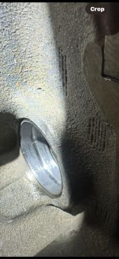

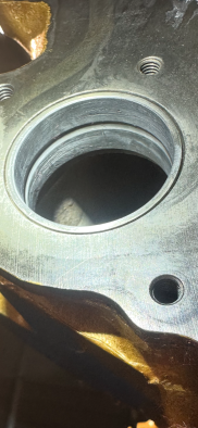

                    Pics of the reinstalled used bearings..

                      Does anyone have a roundabout idea of how much these bearings compress once they are installed?
                      • zaq123
                        • Jul 2016
                        • 1572
                        they don't compress evenly on the whole circumference so it's impossible to say what you are asking. New bearings are not exactly round and become round once installed from what I understand. What your machine shop did (reinstalled old bearing) was done before and not a concern. I just don't understand why the shaft didn't fit after the reinstallation. Did you ask him what clearance they did?

                          to me there is risk that they don't go back to the same position which could affect alignment/concentricity and also roundness might not be maintained. Roundness is easy to measure with dial bore gauge but alignment is not (without a CMM). i would want that verified by some means.

                              thanks for the feedback digger. This is a valid concern. I spoke to another machine shop (Engine Performance and Machine) in Longview,Tx. I showed in pictures of the used bearings that were installed and he thought they looked too crappy to be reused. His thoughts were to order some aftermarket bearings and he said he would make them work. All these machine shops around here seem to think this is no big deal?
                              would it be wise to remove the existing bearings and measure the OD and ID to get an idea of the compressed dimensions?
                              Im thinking that the used bearings could be used as a reference to what the new bearings should be reamed to…
