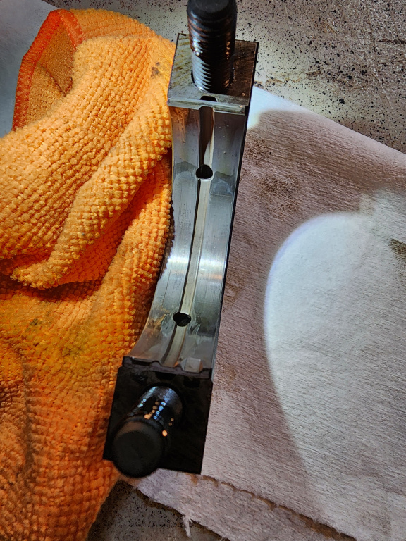

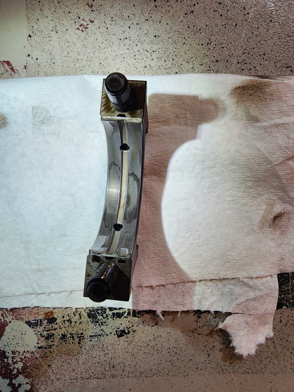

    I pulled and checked the main bearings and they seem a bit worn to me but I don't really have a point of reference. I have included pictures of the two worst bearings below, all of the other ones are either as worn or less worn.

    My current thinking is that these bearings are worn enough to warrant replacement and that the rod bearings (which I have not checked yet) can be assumed to be in similar shape and should also be replaced. Does this seem reasonable? Also is there a way to check if the crank is okay without taking it to a machine shop? I can't see any obvious abnormal wear on it so far so I'm hoping I can just put new bearings in and call it good.

    The pics do not load.
    Normally the crank journals are a visual inspection and fingernail test after cleaning. If you are unsure whether the bearings are good or not then it is unlikely the crank is damaged (w/o seeing pics).

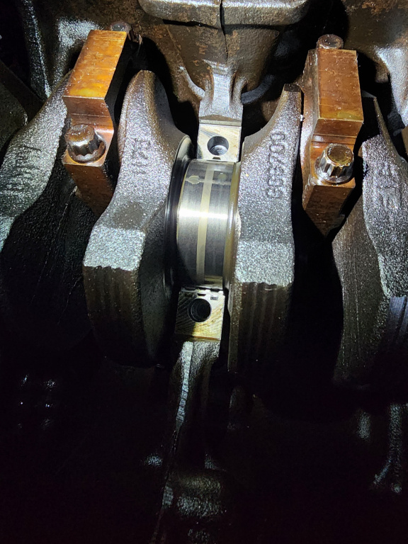

      And good to hear about the crank, I'll take a closer look at it but upon initial inspection it seemed fine. Here is a picture of one of the journals.

        The bearings are worn and should be replaced, the rod brg will likely be slightly more worn than mains. That journal looks ok but more important (more likely to show issues) are the rod journals.

          I would buy new bearings, let a machinery shop polish the crank, new headgasket: Elring, Reinz, OEM, new head bolts or ARP studs. Put together and run. Rod journal is most important as digger said.
