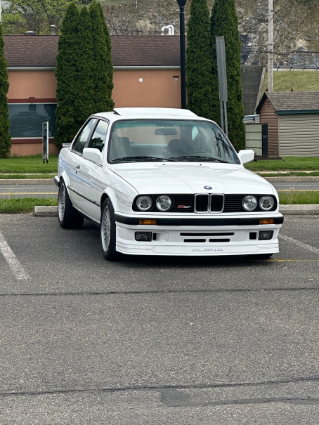

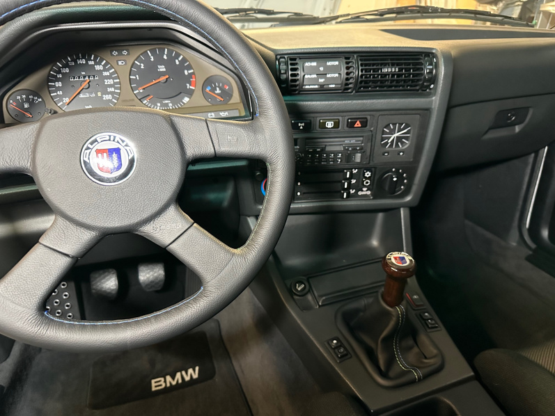

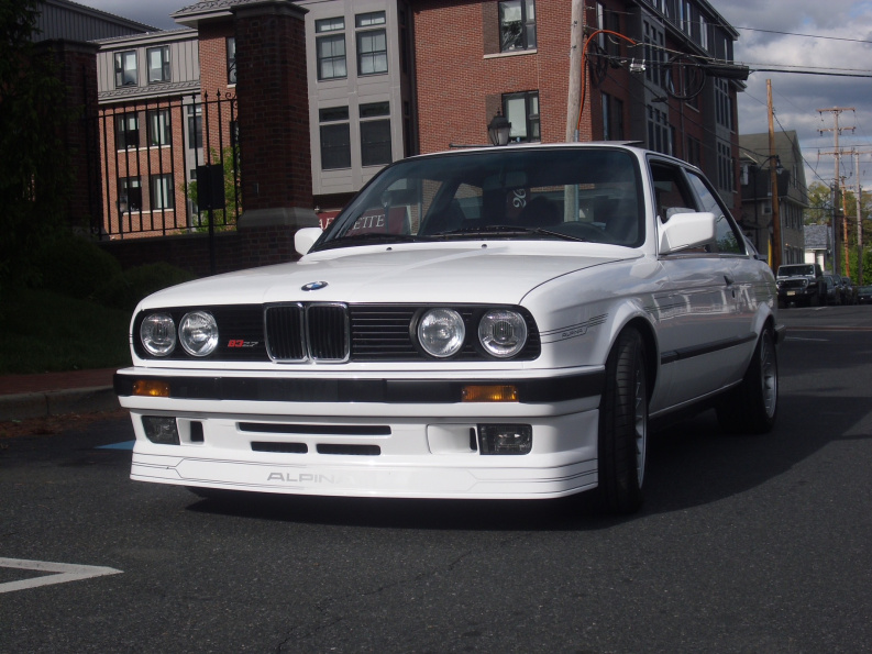

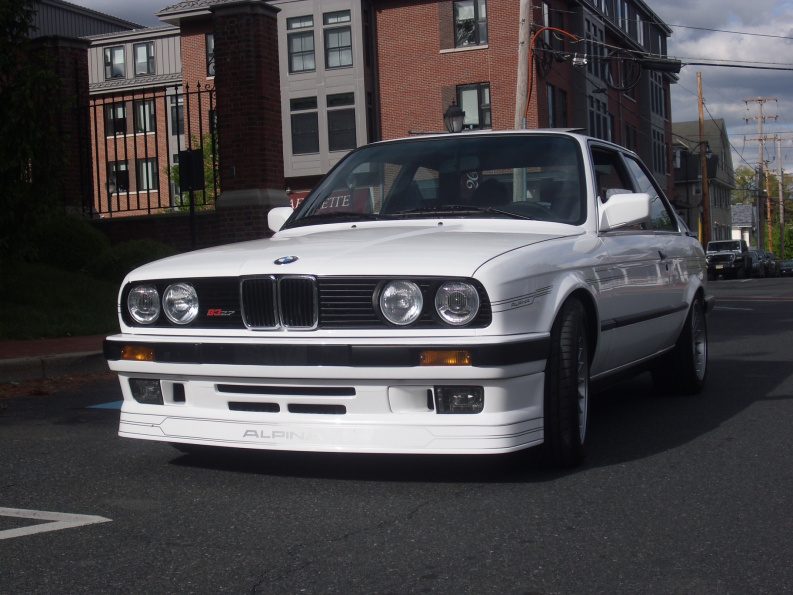

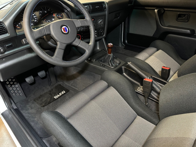

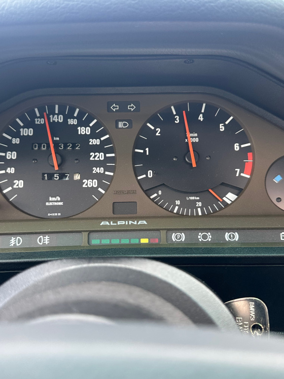

          Here are a few pics of my project I'm working with.... to keep this post somewhat entertaining

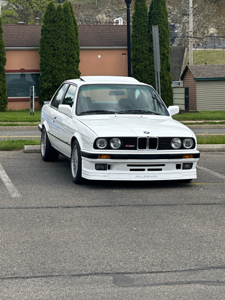

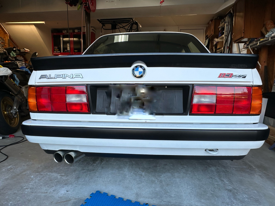

              That is a nice ride. The preface lift Alpina front airdam is the best there is. The Alpina C2 2.7 was probably what got me into E30's in the late 90's. Were you able to find some good boots for the rear wheels?
              Mine is supposed to be 11:1 but i never checked, i suspect it is more like 10:1 based on recalling some discussion i had with Metric mechanic along time ago plus i am using a +0.3 mm head gasket. i will have to find the old laptop where i have the software as i can't load the software onto windows 11 and also its on the assumption that the tuner actually properly checked and set the offset. This is one reason why i purchased a Haltech to replace it
              • zaq123
                • Jul 2016
                • 1559
                Toyo proxes TR1 in 205/50 front and 225/45 rear. Pre-face Alpinas are very nice indeed. All this started because one EX valve stem was mushroomed when I got the car. Head came out.Machine shop took their time and I added to bore the block to the order. While that took time I got to the body/paint and at this point there is not a single bolt/nut I haven't turned on this car. Hardest part was to paint the car which I did myself in my home made paint booth. Something I don't want to do ever again.
