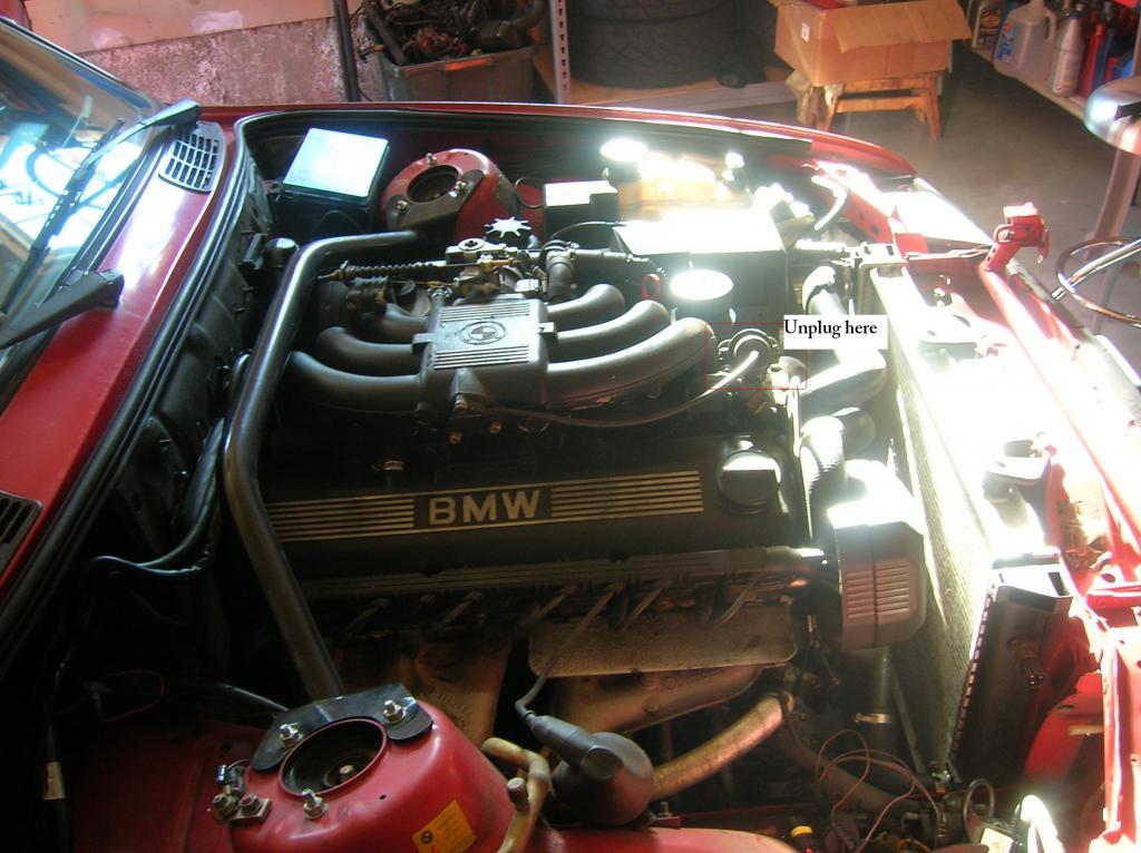

    There is a small vacuum line going from the fuel pressure reg to the intake manifold. Unplug that and insert it into the can let the vacuum pull the fluid out of the can.

      It is recommended to use 1/3 can into the intake and the rest in the gas tank.
      Keep the rev's up so the motor doesn't die, suck the fluid in, then turn the car off plug the vacuum line back in and let it sit for 10 minutes.
      Then fire it back up and smoke the neighbors out! You're done.

        Be careful it sucks it up pretty quick

                          Well, I Seafoamed my baby last evening. Disconnected the O2 sensor in case the carbon deposits might screw with the sensor. Poured 1/3 of the can into a Ball Mason jar, took a sip myself for gook luck, then with the car cranked I pulled the vacuum line and let it sip little gulps of the white lightning from the Mason jar. I kept one hand on the accelerator cable to rev the engine a bit when it tried to bog out. When the jar was empty I let the car sit for 10 minutes.
                          For good measure I had myself a second sip of Seafoam, then poured 2 more ounces into the Mason jar and repeated the process. Let THAT application sit for another 10 minutes, then poured the remaining Seafoam into a full tank of 93 octance gas. ( I have a chip.)
                          Then I started her up and like Gomer Pyle says "Shaazaamm".
                          The area between the driveway and the street looked like a special OPs team had dropped smoke and teargas bombs. The rear of the car spewed out stink bombs. I reconnoitered the area and dropped many strategic F-bombs. I think I injured my carbon footprint. While I was assessing my damaged footprint the neighbor came outside and retaliated with a set of tactical F-bombs.
                          When I took it out for a spin it was still unloading metric tons of smoke and people behind me were scared of possible bombs. But after about 4 miles the car seemed to have much smoother/stronger pull, and at stops and intersections the little hitch in my idle giddyup was gone.
