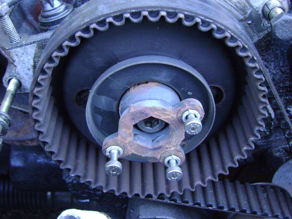

                Sorry to revive an old thread but I just want to make certain about the cam sprockets because I'm going to be doing the job this week. Also, can anyone tell me why my eta cam sprocket doesn't have the hash mark for timing?
                Maybe Jim or nando can chime in?
                  I've never seen a cam sprocket that didn't have a mark for cam timing, be it from an M20B27 or M20B25 head. It is kind of essential that there be a mark. To the best of my knowledge, the cam sprockets are interchangeable.
                  Jim Levie, Huntsville, AL
                    That's what I would have thought. Here's a pic of the sprocket with the harmonic balancer at TDC
                      That type of cam sprocket does have a mark. It's an arrow on the inner portion of it pointing out towards the teeth. You just cant see it in the picture because its on the bottom half. I bet if you rotate the crank shaft around 2x it will be lined up on the cam sprocket also.

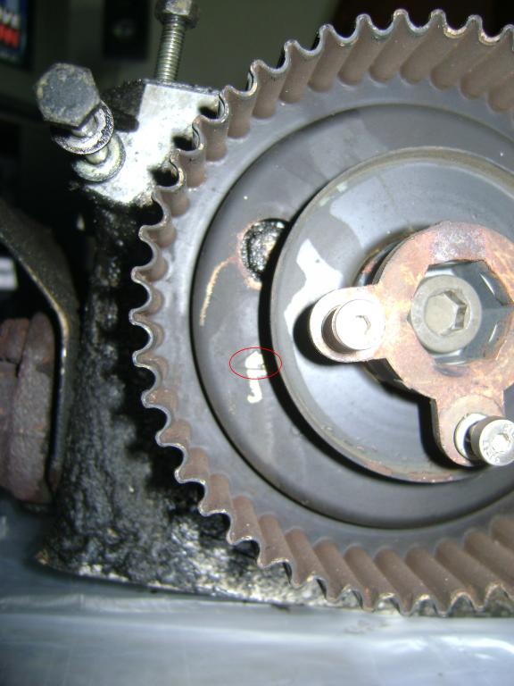

                          Early ETA's had the stamped steel cam sprocket. The timing mark is near the center and an actual arrow. If turning up the RPM's, run the i cam sprocket as I've heard the stamped steel sprockets can fail.
                            OK, just in case anyone else runs into this here is a pic of the arrow. Wish it was located at the periphery, where would make it easier to see and line up with the other mark.
