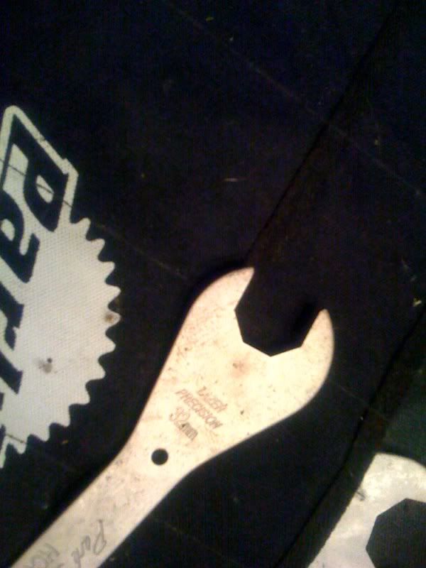

                        • 2.5-12
                          • Jan 2010
                          • 1814
                          OMFG!?!!?!!!!!! LOoOkook what I founded in my garage shelf thingie from my cycling days!
                          !!!!1
                          1
                          1!!!!!

                          • 36brua
                            • 689
                            !!!!1
                            1
                            1!!!!!
                            Win !!!
