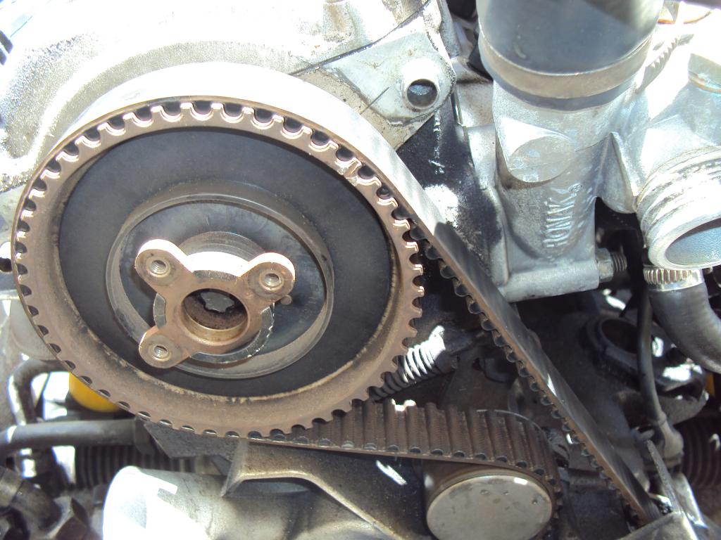

                  PS: I haven't figured out how to crack the camshaft sprocket bolt without turning the valvetrain? TIGHT! Need to change the seals in there. I'm gonna take the belt off as not to move the bottom end first. OR should I leave the belt on in case the valvetrain moves

                    As for removing that bolt.....put a ratchet on the crank pulley and make sure it can bottom on something....ground, chassis, etc. It'll come out.

                        Hold the Crankshaft Pulley against the ground while I undo the camshaft bolt?

                          Damn F'in worked. got the bolt cracked and didn't mess up the timing marks.

                            Touching Cam!

                              Make sure you either torque that cam sprocket bolt bolt to spec, get a new bolt, and/or use loctite (whatever is recommended, I forget). Mine cam loose after I did the cam seal, and did some damage.
