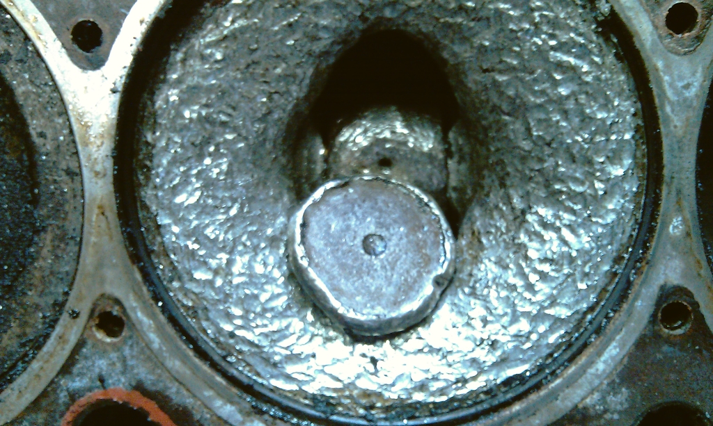

                      can anyone explain how something like this would happen? Gasket was completely fine. all other cylinders fine. Piston 3 has a freakin hole, burnt the exhaust valve clean off, melted the spark plug out, and scarred the shit outta that bore.
                      now im outta a car and money after buying a bunch of shit to put the 325i head on :( im thinking of abandoning e30s and going with a camaro again...

                          i was sooooo excited after gettin that fan clutch off and all the rusted exhaust nuts...only to be greeted with more agony :(
                          im really surprised to see that head gasket hold up. i believe this issue was the cause of my crazy slow acceleration
                          i mean look at that! how does one burn a freakin hole in a piston...STOCK???
