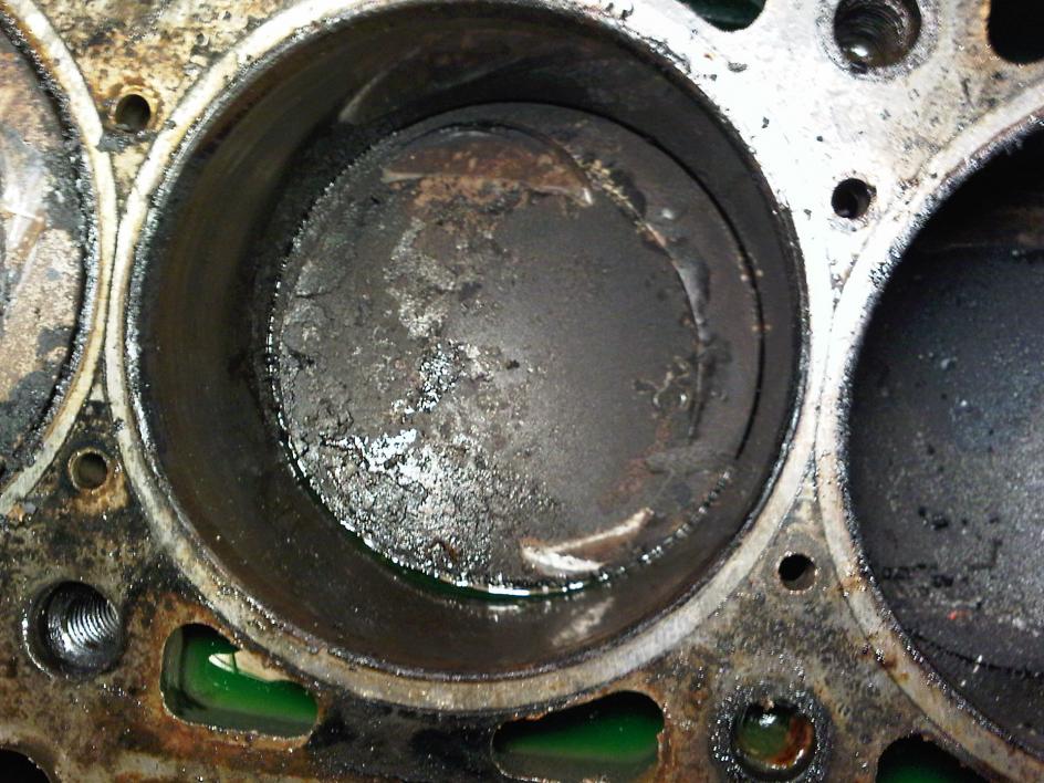

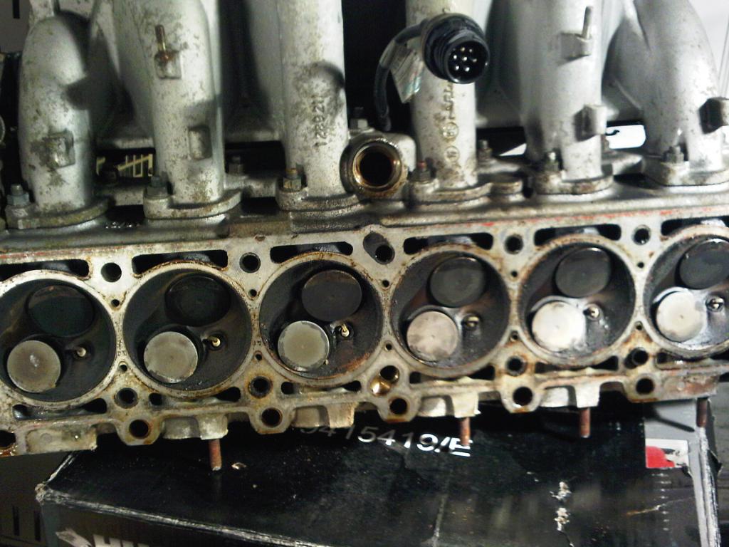

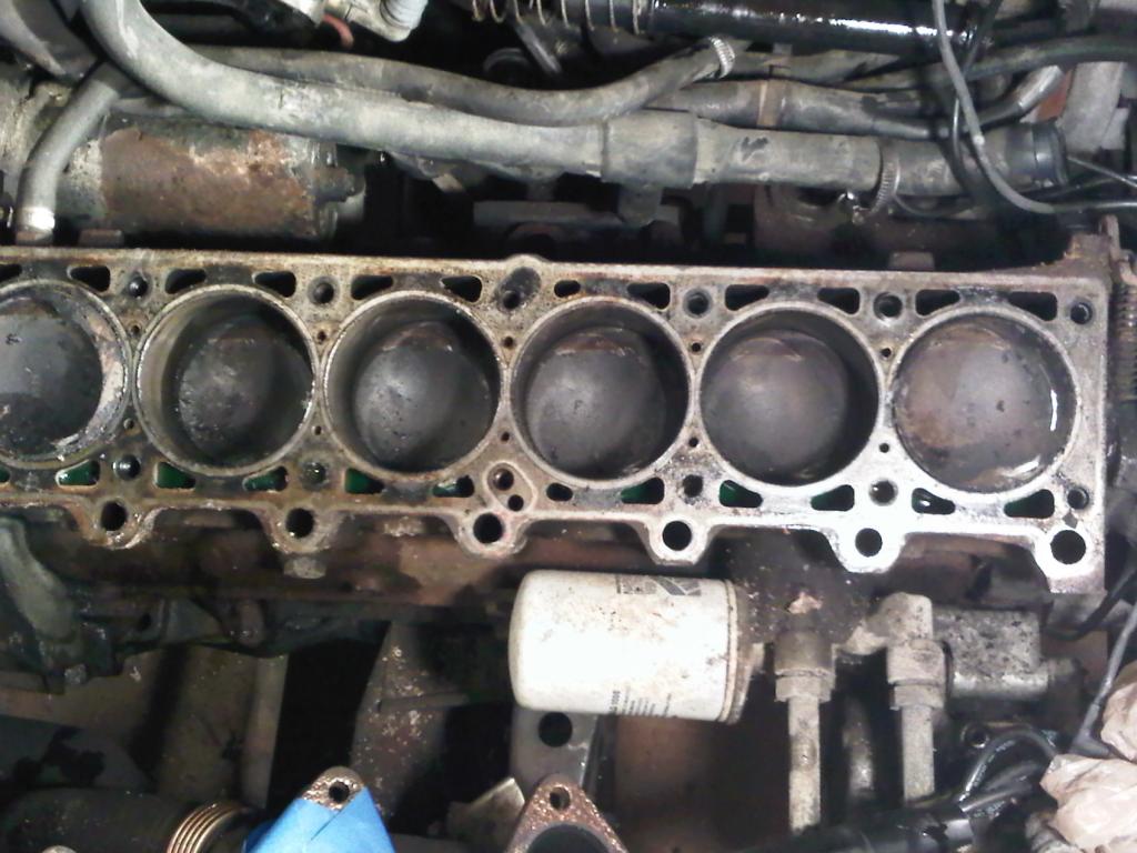

          Originally posted by myfirst325
          The car only has 55k miles so I was a bit surprised to find how bad everything looks.
          That's a lot of carbon for only 55k. Dead odometer?
          S52-Powered 1987
          • nando
            • 34827

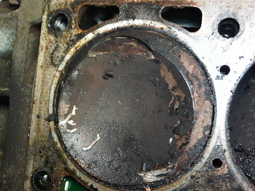

            So I was able to pull the head with the intake manifold on. Here's what I found. The car only has 55k miles so I was a bit surprised to find how bad everything looks. All the cylinders have the crescent moons on top of the piston heads. Is this normal? The intake side crescents are thicker than the thickness of a quarter coin. None of the piston heads have holes so I'm wondering if I can just clean up everything really well and throw in a rebuilt head.
            those are the valve reliefs - they look fine. doesn't look like any valves broke off or anything so you can leave the bottom end alone, just clean it up.
            as far as the carbon deposits - it's 20+ years old and has only 55k. If it was driven often, it was driven for very short distances (5 miles or less). The engine never had a chance to warm up and burn any of that stuff off. So it gets built up.
            Build thread
            Bimmerlabs
            • myfirst325
              • 107
              Perfect! Can I use crc brakeclean or is there something better perhaps carb cleaner? I was able to locate two used heads one from an is and one from an i, neither convertibles. I have an IC but my understanding is that the engines are the same and the heads are designated 885's.
              The car lived on the east end of long island ny so it makes sense that it would be driven very short distances which explains the build up. thanks for the explanation!
              • nando
                • 34827
                that's what I used. also you can get a "roloc disk" made by 3M. get the softest one because the stiff ones chew through aluminum. soak the pistons and go over them (at TDC) with the wheel - don't use it on the block surface though. then suck the crap out with a shop vac and rotate the engine a few times wiping the cylinder walls clean. it will still burn a shit-ton of carbon after you start it up again, but it won't hurt the motor (lots and lots and lots of white smoke).
