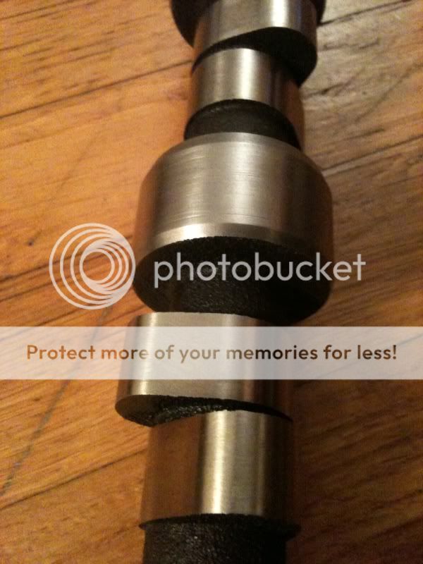

    And just so that this thread isn't too boring, here are the build specs and some pictures so far:
    M20 block, over-bored, cleaned, resurfaced
    new 0.5mm oversized seta pistons
    eta rods and new rod bolts
    eta crank
    new main and rod bearings
    "i" head, decked, cleaned
    schrick 288 cam (if anybody wants to trade me their 274 or 272 let me know)
    Believe it or not, this cam is used:

                    Nando, I am aware that the cam is too big for my CR. I had a long discussion with Mr. Rowe about it. I have the cam already, though, and it was stupid cheap so I figure that I'll try it anyway. If you want it and have another to trade let me know.
