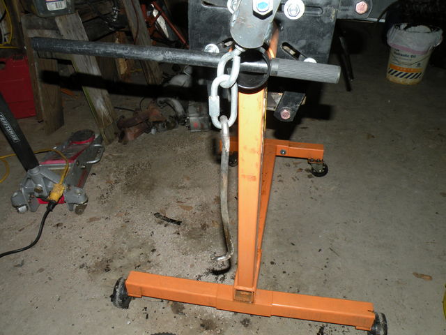

              You pretty much have to have a hoist to pull an engine (or a lift). If you also get an engine load leveler you can remove/install the engine & transmission as a unit in far less than it takes just to separate/re-connect the transmission.
              The rear lift point becomes easy with a j-hook. I made mine from a piece or 3/8" rod. Basically it just a piece of rod with an eye formed on one end and a shallow u-shape on the other. Mine is about 11" long. So I can hold the eyelet end and place the hook in the lift point.
                  J hook is a great idea! I always pull both together, it is much easier, at least in the E30. Can you post a pic of that j hook?
                    I'll try to remember to get a picture tonight.

                        Here is what my j-hook looks like.
