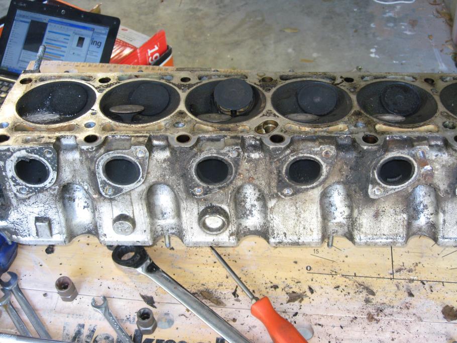

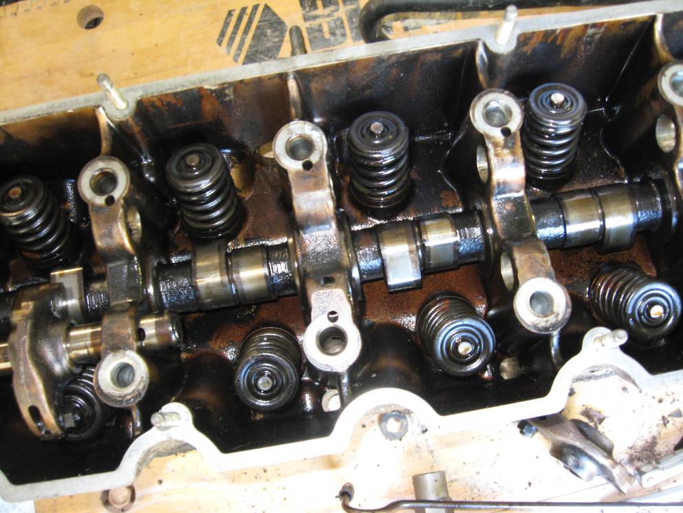

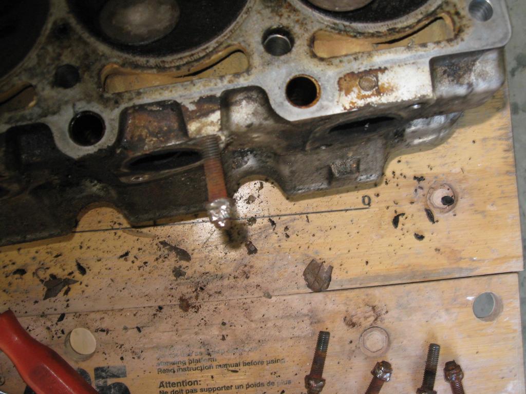

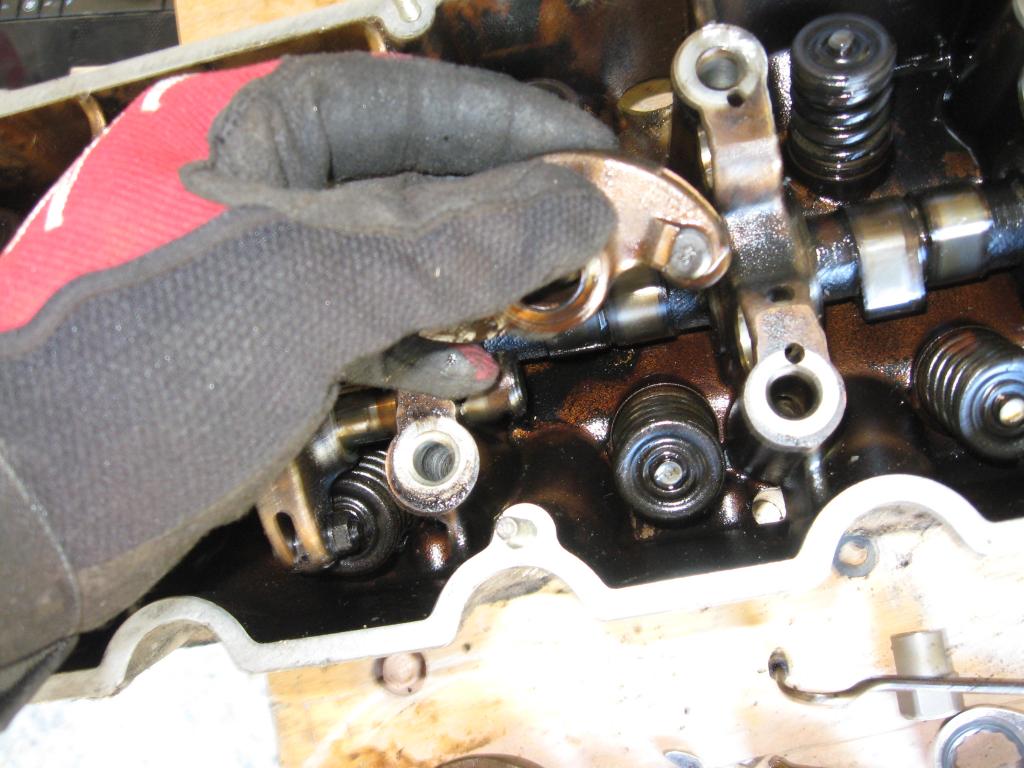

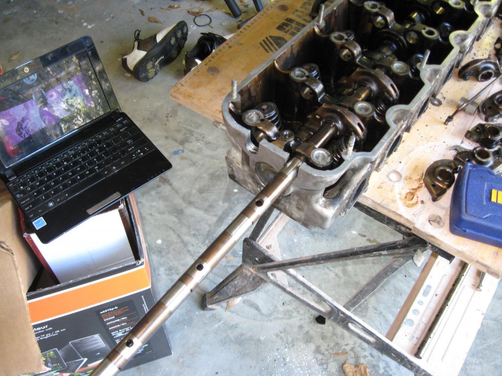

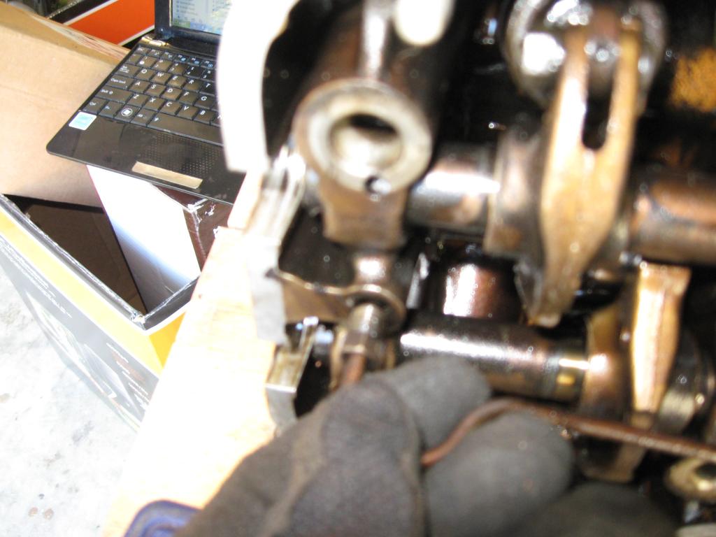

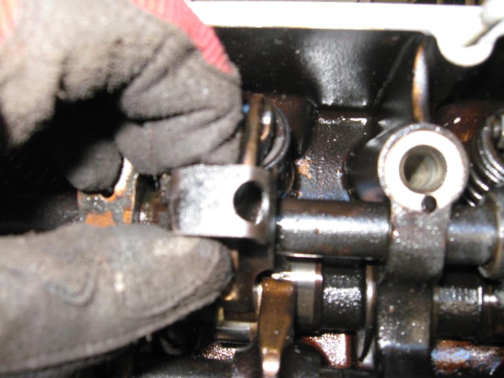

                            everything going in will be new. 272 cam, springs, rocker shafts, everything here are some pics. the first thing i did was pull the exhaust manis off. the firts pic was a nice half cut off stud i pulled without breaking. :D. than i pulled off the oil line on the top which took an 8 mil wrench. than i went ahead and pulled out the rocker shaft seals, and took a long extension and knocked out the rocker shafts.

                              more pics
                              more pics
