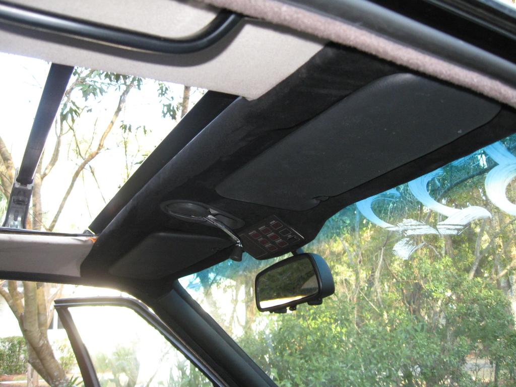

                      my main goal today was this. i re wrapped the check panel piece and its very nice.
