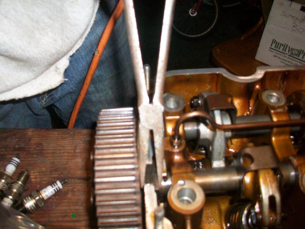

    I used a thin coat of rvt and its works out fine. I guess this is a matter of preference. I pulled the gomets out with a pair of pliars and used a small rubber mallot to put the new ones in.

        thick side in...they rest against the rocker shafts.

            I don't recommend rtv for those rubber plugs. They eventually shift and shrink over time. Use something than can continually conform with the rubber / gasket surface like Curil K2.
