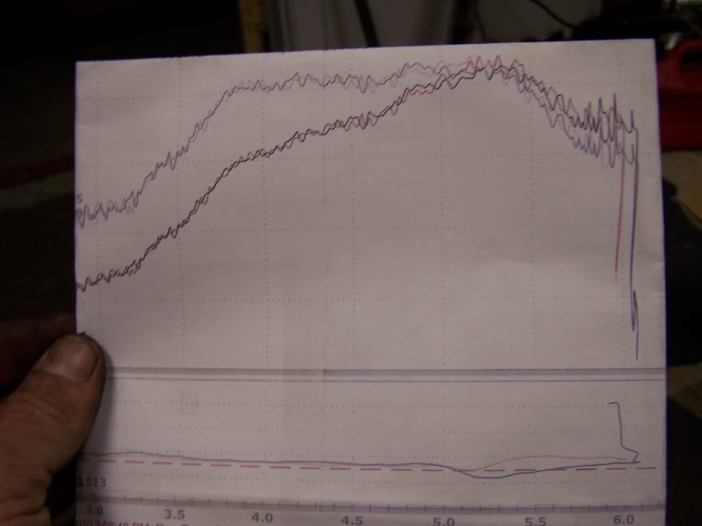

                            Originally posted by nando
                            your engine is just old. 133hp isn't that unexpected from an original M20, even if it does have some work.
                            what's the curve look like?
                            Right. Everyone flamed me for making 134 with my 2.7 and low compression.
                            Here's the all stock parts graph...
                            and the tuned graph, added 2.25" exhaust after eta merge pipe - numbers omitted, obviously, will release dyno results after back to back consecutive runs (90k mile bottom end)...
