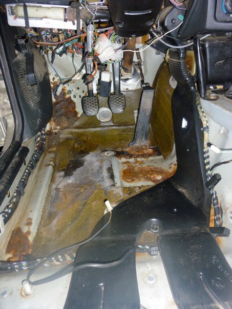

    The car has rust holes in the driver side flooring and I'm trying to decide whether to get the engine up to 100% before taking it into a shop to get the rust taken care of or vice versa.
