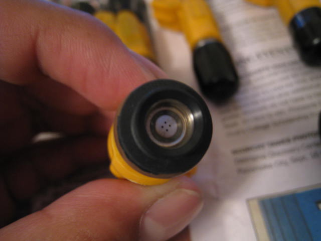

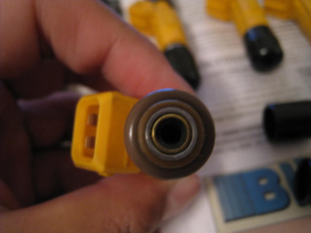

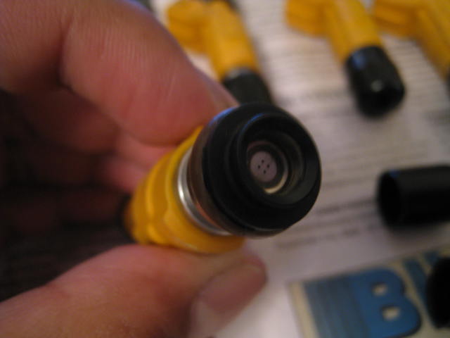

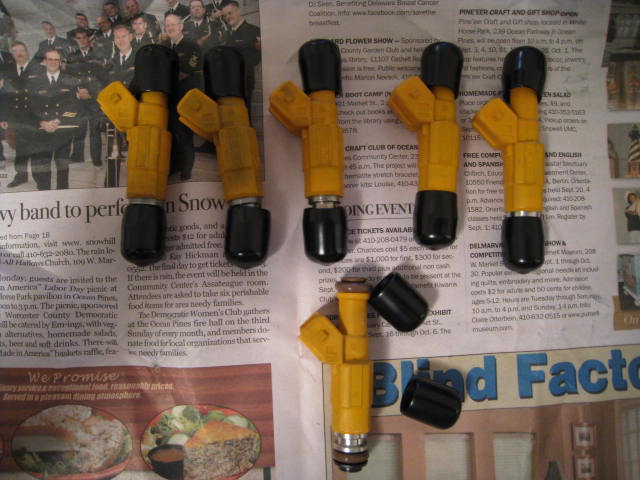

              I just got these on ebay from smokestackj. This is what he advertised:
              All injectors are tested, ultrasonically cleaned, re-tested, and rebuilt with new filters, pintle caps and proper Design III pintle caps, not yellow Design II caps that have been cut down with a razor blade as these have a tendency to fall off. These are a direct drop-in, no modifications to fuel rail or wiring harness needed. Each injector has a lifetime, 100% satisfaction guarantee, with free replacement.
              I'm stilling waiting for my multimeter so I can test the resistance. I'll let you know how it goes.
