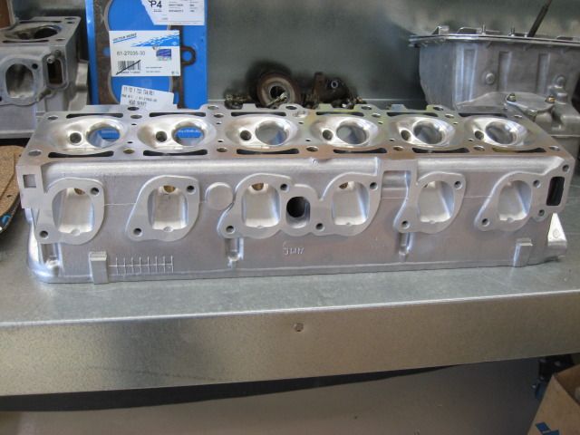

                  car is a circuit racing car, 14.5:1 compression, E85 fuel, carbs are modified 45DCOEs, cam is custom, 275* duration @1mm, .550" lift at the valve, it is not a streetable engine, you can't give full throttle below 5000rpm, or it spits back through the carbs, but once you hit 5000, all hell breaks loose...
                  it is a dyno dynamics dyno in shoot-6 mode, you can't alter anything at all, so can't be fudged except by heating intake temp sensor, here is a screen shot to prove that temp wasn't fudged either-
                  and a few other pics, there is a week of full time head gurus work in the head alone...

                    I am a little surprised at the AMC head, though. Guess they're decent castings afterall.
