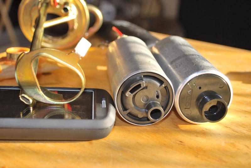

      The difference. They're oriented the way they fit in the mount, respectively.
      BOSCH left, VDO right
      • JayDee916
        • 304
        The replacement did not come with the assembly. just what is shown on the left. I'm asking if I can get it to work in my VDO assembly.
        • JayDee916
          • 304
          Main problem I'm having is the bottoms shown here, again BOSCH left VDO right with the VDO housing on the far left. The little cresent shaped nub on the bosch doesn't allow it to fit properly but I just realized that it is ONLY a nub and not an actual line for something so I guess Ill just grind it off?
          Then there's the issue of the sock being for the larger VDO opening but that should be simple enough to adapt.

              I think he had the wrong pump
