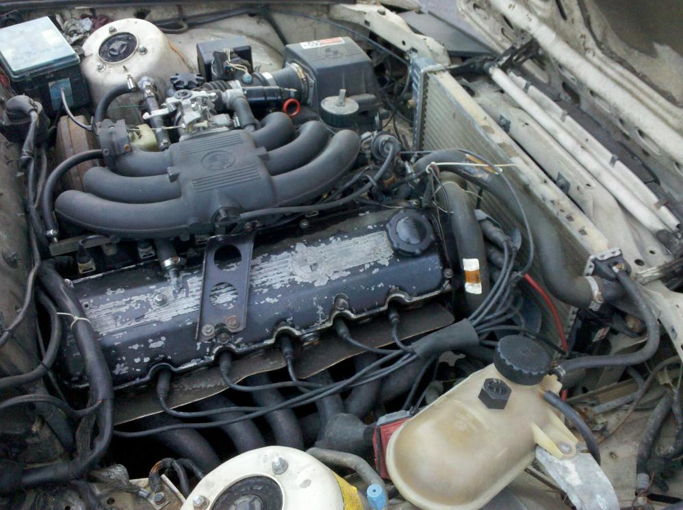

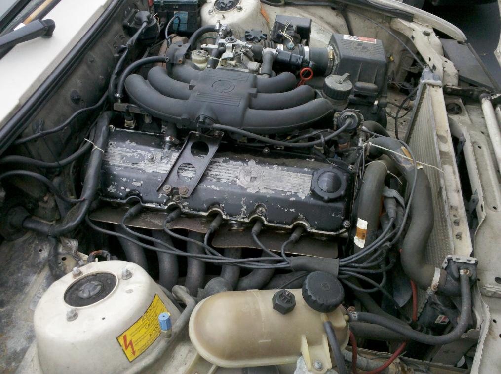

        Here's the OP's engine bay:
        It's definitely running the i wiring, sensors, and ICV. It's got the i intake manifold and throttle body but it's got the e valve cover. Most likely it's a 2.5 with the wrong valve cover but one will not know for sure without checking the numbers as suggested above.

            There's some mismatched parts on that engine so chances are it's not just a 1990 M20B25. What does the head casting say in between cylinder 1 and 2 plug wires? "Set up for turbo" typically just means it's an ETA with an i head, which might explain the ETA valve cover and brace.

              The only number I can see is "15" between the front two intake ports. and the block has "2.7" stamped on it.
              Here are a couple more pics of the engine bay

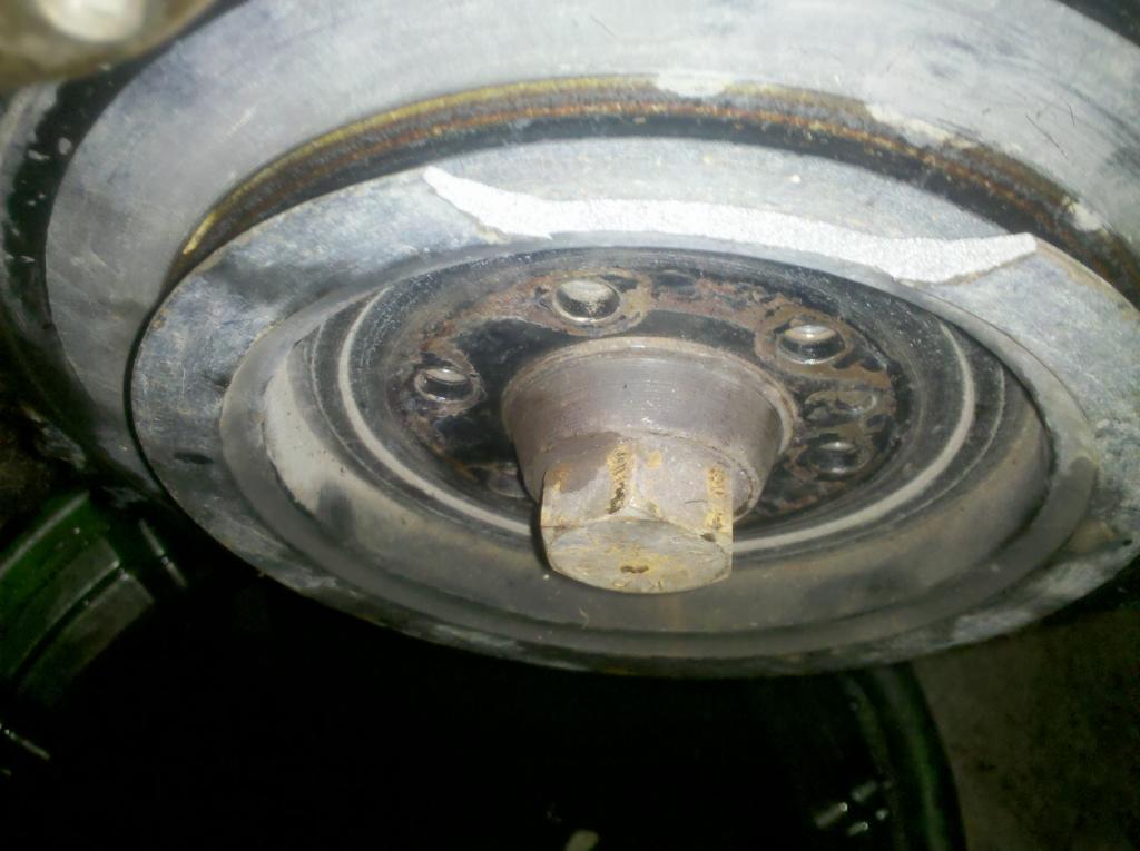

                Upon replacing the timing belt: The nut on the crank on mine is 1 1/16in, not the 22mm as I have read, which I thought was odd. Now the instructions say "Although it might look that damper is held in place by the crank nut, it is not." but I could not get it to come off with the six bolts removed so I decided to put a puller on it, and COULD NOT get it to move, and I broke it. Im currently screwed because NOBODY has or can get one of these except the dealer and they want $260 + $50 ship and I have to wait 2 weeks to freight it from germany! Does anyone have one I can buy I need it ASAP

                  Hit up your regional forum or go to a pick and pull to find another pulley. Not sure why yours didn't come off. Is there a washer between the crank nut and the pulley?

                    Im not sure, It doesnt really look like it. Heres a close up:

                      Would this work? http://www.ebay.com/itm/HARMONIC-BAL...item563deb84bb
                      But mine Has teeth around it for the CKP, and this one doesnt?
