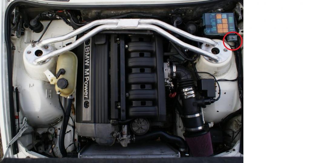

    Can anyone tell me what this little box thing is with two fuse or resistor looking things in it is? It has two wires going into it on my car but no wires coming out Car is an 87 325e with a build date of 11/86, Any help is appreciated.
  • TStroop
    • 188
    This is not my car found this picture on here. I am currently swaping a 88 325i engine into it with a 87i engine harness and the dme out of an 88i

      I think that's the fuses for the main relay and fuel relay. Don't quote me.

        They only have two wires going in but none coming out so if indeed they are how the hell does it work

          It's an accessory fuse box. That style was only on early model cars.
            Correct. One fuse is hot all the time and the other hot only when the ignition is on.

              Ok it has 4 screws for wires there is only two wires in it, is there supposed to be 4 wires?
                That fuse block was for aftermarket additions. If none were added there will be two wires in and none out.
