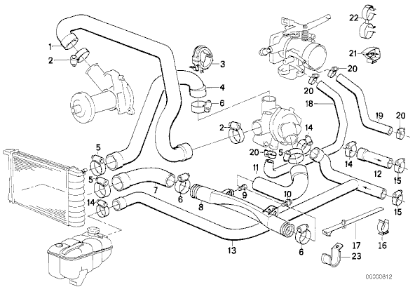

                      Originally posted by Ninz30
                      wait I'm confused the t-stat mounts to the block, but there is no gasket between them.
                      No, the thermostat housing mounts to the head and there is a gasket. Part #4 on http://www.realoem.com/bmw/showparts...59&hg=11&fg=35
                        ummm...YEAH!!! :-)
                        pic two: part #4. is the gasket you need.
                          Originally posted by Ceeker
                          ummm...YEAH!!! :-)
                          i stand corrected :D
