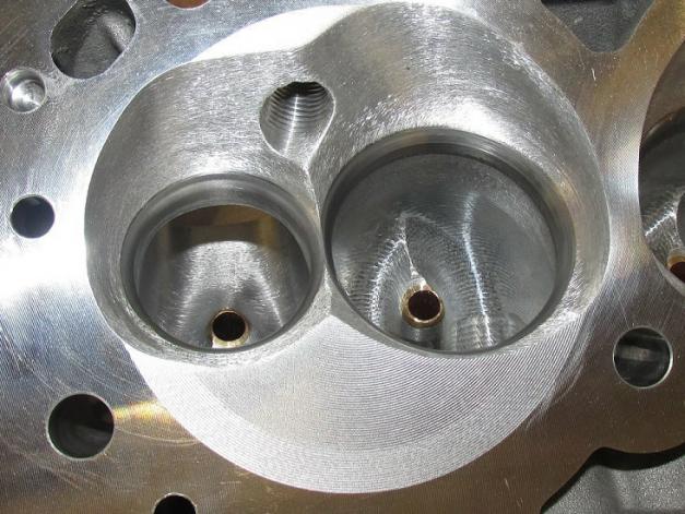

                      Seems like the flat top and 885 head combo 'could' be advantageous for boosted/nitrous engines, would be an interesting dyno/drivability test for the m20 on both combos.
                      a couple relevant videos - intentionally creating this combo 'chamber softening'

                        #86
                        Click image for larger version  Name:	dart1-2-orig_orig.jpg Views:	0 Size:	58.2 KB ID:	10055529
                        One difference between these kinds of head and the m20 stuff is the domestic stuff especially on the shallow valve angles have a huge % of the bore area as squish area so they can generate too much mixture motion. You'll notice they still retain some flat squish but are just not wanting too much. i also think that the "angle" of the M20 squish band on 885 is a fair bit steeper.
                        I believe FF has done several builds and still favours the OE dish dome but im sure he will eventually chime in
                        one thing is how would you even know if it’s better or worse ? This is something you probably need cylinder pressure trace to understand imo. Of it takes more timing or makes more power it will be impossible to understand the mechanisms at work without sophisticated measurement systems
