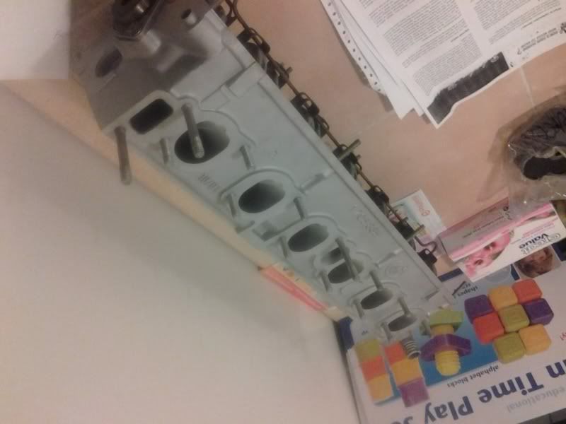

                Little update. Getting the head sent out tomorrow for decking,hot tanking,valve job , leak test and everything eles. Will order all new gaskets/parts tonight. Couldnt find the 87i harness so ill ve using one from a 90. My only worries are the o2 sensor since im going to run the stock e exhaust.

                          Small update.
                          Picked up a head/intake and tb about two weeks ago. Had the head sent out. Was sand blasted,hot tanked deck .0100 , valve/seats ground new guides and a little more work. The head looks brand new. Got my parts from pelican few days ago and got all my I swap parts yesterday. Looks like weds. I will start the build. Ill be sure to take pix. Total amount spent for swap and rebuilt head 520.00

                              pix of the head b4 and after
                              dirty head straight from the yard.
                              clean head from the machine shop
