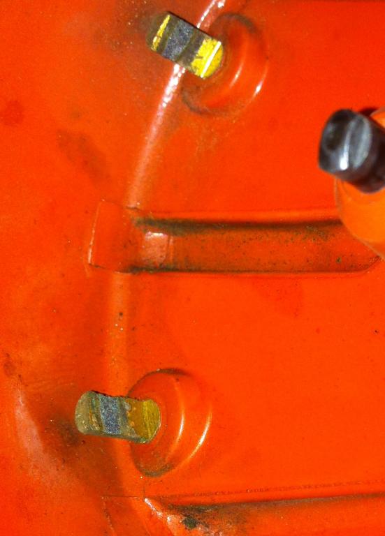

            I would check the cap and rotor again. I had the same symptoms as you. Turned out it was a worn cap. Gave a spark but wasn't grunty enough in the cylinder chamber to fire. Look for pitted electrodes and also moisture/dampness in the cap can cause problems too.

                          I checked everything I could think of, TPS switch, air flow meter, wiring and connectors, cold start sensor, knock sensor, spark plugs, even removed the injectors and had them tested. I was getting spark, fuel, and air, so this was adding to my frustration. As a final resort before I set it on fire, I decided to check to the cap, soon as I saw it, yip there's my problem. A new cap and rotor and it started first time.
                          This is what my old cap looked like...

                              Heh, I was showing GSpeed what my stuffed cap looked like. Maybe it was the cap and he can't decide to give too?
