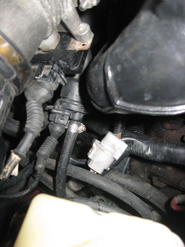

                      #55
                      Here are a couple of pictures of tmy clip for the injectors (grey connection) and what i believe is the factory wiring for the injectors. I found this in a spare parts box that came with the car. Do you think this is a homemade connection? source of problems?

                          Check the resistance through that grey connector, 9 times out of 10, the mech who put those on doesn't know how to crimp.
                          You said it ran before?

                            #58
                            That looks home made to me. A harness from an 87i is the best to use on I swaps. Takes about 20 minutes to remove and cost $20 at the yard.

                              #59
                              Hey guys, a little update. I pulled the injector wiring apart and found a wire that wasn't connected at all. Got it connected and re installed everything. The car started for a split second and died. Cranked a few more times and actually idled for a 5-10 seconds. Sounded great but died again once i touched the gas... any input? I scanned the diagnostic port again and got a code for a coolant temp sensor. I've heard this can cause running issues but shouldn't cause a no start.
