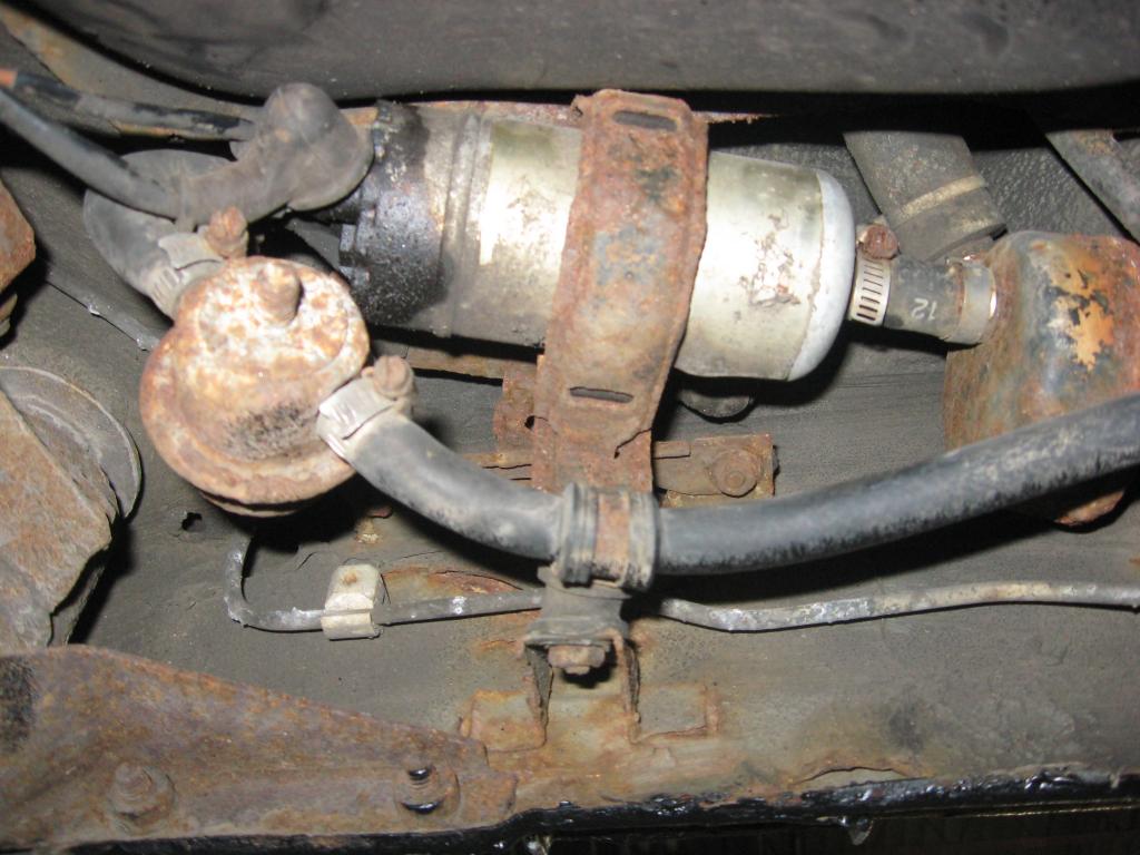

          Hey Guys,
          I have this pump as well as the one in my tank, anyone know which ones i should be replacing them with? Do both need to go?
          Mike
          • TS87325IS
            • Sep 2006
            • 821
            #65
            The one in the tank sounded like your original problem
            mods: just meat and potatoes under the hood and wheaties on fire out back ;)
            • FLG
              • Sep 2011
              • 3165
              #66
              That one dont look too good. Looks to be leaking too.
              Sent from my Galaxy Nexus using Tapatalk 2
              -Build http://www.r3vlimited.com/board/showthread.php?t=295277
              • u3b3rg33k
                • Jan 2010
                • 2452
                #67
                Delete that rusty piece of crap after the fuel pump in the line. BMW stopped using them (replacement part is a straight through coupler), and they eventually rust/leak.
