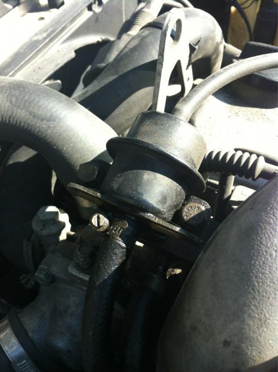

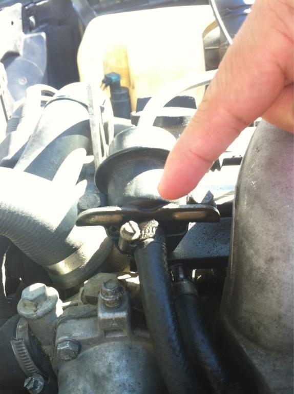

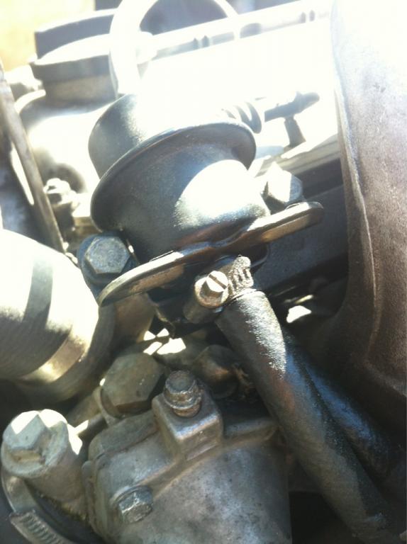

    So, I am ready to take my car to Pj Bonifacio to get some paint work done and started to smell fuel and lots of it too. I open the hood and see gas leaking from this. any you guys have encountered this problem before. I have been going from one problem to another ever since I bought this car.

    The round object is the Fuel pressure regulator. I can't tell from the pictures if the leak is from the hose, o-ring under the FPR, or the FPR itself.

      When it was running it didn't look like it was the house, it was coming from the top of the fuel regulator. I will check it out to see if it is the O-ring. Thanks for the reply.

        Update, fuel line was just loose and easy fix and no more head ache.

                In the pic, the hose clamp has been tightened excessively and is cutting the hose.
                The OP has stated that the hose was loose and has torqued the clamp further.
                The hose is brittle at the end.
                It needs to be replaced.

                  I concur.
