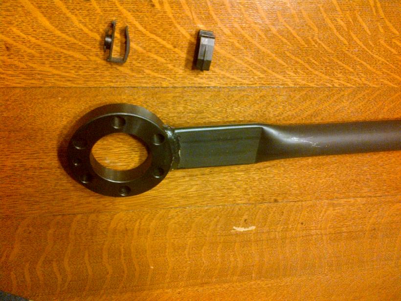

            you will want to use this:

              This is one forum where I guess it's ok for someone other than me to post a pic of my tool :p
                  None of my working-on-the-car clothes are that clean!

                    The crank nut is a standard thread and I doubt you will get that tool on a loaner program. I got mine from bavauto cause they were the cheapest at the time and closer. Last I heard they were out of stock as SIR tools only makes them in batches.

                            Yes, photo creds go to jeffnhiscars.
