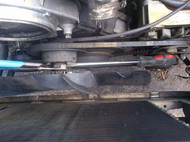

    My water pump went out, and i cant get the radiator fan off, every time I try to take the bolt off, it just spins the fan. Am I doing anything wrong? What can i to to stop it from spinning?

    Screw driver between the heads of the bolts that hold the pulley to the water pump.

      Like so !!

        Or buy the tool to do it. Its $20

          Its also reverse threaded...

            I got it, thanks guys
