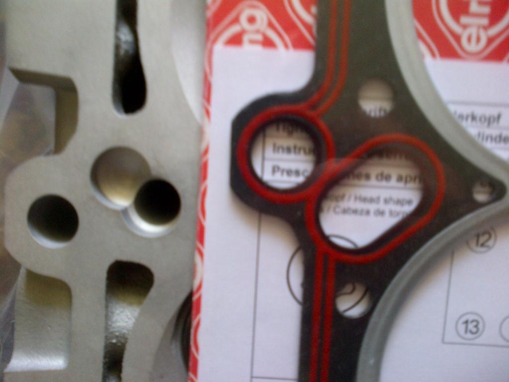

                    so i knew someone would ask this question so a few months back i took a pick of the 3 most common gaskets.
                    Left to right: VR, Elring, BMW
                    Personally it's BMW or nothing for me.

                        on my eta the VR gasket was no issue. on my "i" the bolts stretched and the gasket started leaking after 50miles. on my dad's "i" had no issue for ~5k now it's a slight leak.
                        now im running the BMW gasket and ARP studs. no leaks no issues 10k on it. (bit over kill)
                        I wont dispute the quality of a BMW gasket but the different in that opening being bridged does not strike me as being useful. Based on how the head is milled water will actually pass AROUND that bridging piece of the gasket since it doesnt seal anything. Makes more sense for it not to be there.

                          Sorry, it is not the bridge that i care about. it's the thickness and quality of the bead of silicon. notice the VR has about 1/2 of the Elring and that is about 1/3 less than the BMW one.
                            Understood. It's been a long time since I was up close and personal with a head gasket & I can honestly say I've never seen silicone on one until this. Maybe its because the last heads I did were cast iron :-)
                            Silicon is cheap so why would one mfg would use less than another if there was science that it made a difference. I'm not saying it doesnt matter, but that I've never seen it discussed.
                              And also understand, that this can vary out of any given batch of the same brand cylinder head.
                              This is the kind of internet wisdom I am referring to.
