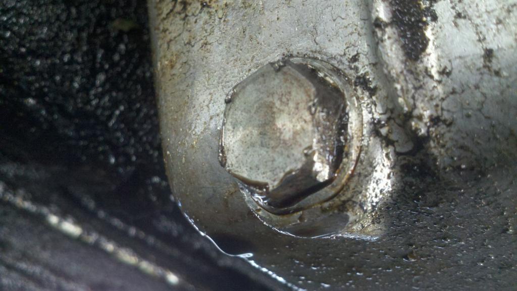

    so i was trying to change my oil over the weekend and i noticed my oil drain nut has been shaved down from a bad scrap i guess. I dont recall scrapping hard since my last oil change but it is what it is i guess. My question is does anybody know what i can do to remove it? i tried wrenching it off but it wont turn because of how bad it is. Should i take it to get cut off? Im not quite sure what i should do.
    Kind of hard to see it in the pic but the bottom of the but that has been flattened also has part of the oil pan folded on it from where the pan hit the floor which prevents it from rotating.

    vice grips! Thats how i get mine off lol. Shits also shaved way down.

      mine is pretty messed up too, i'd use vice grips. You should see how many vbands i go through on my exhaust. I've ripped at least 5 off sense i've put it on. I don't know how people run a 3in exhaust on a lowered e30

          man i cant get it off. basically where the pan hit the floor, it pushed or folded onto my nut and is preventing it from being able to twist. if that makes sense.

            drill.

              Get some of these:

                  Originally posted by NitroRustlerDriver
                  Get some of these:
                  What are those?

                    Word. What are those?

                      they are bolt and nut extractors for rounded bolts and nuts
                      obviously if it was a broken bolt those wouldnt work ud need a reverse drill bit or screw extractor for a drill
                      but yeah if u have screwed up bolts that u cant get off those work wonders. we use em when lug nuts get stuck/rounded off
                      fyi if u want a good way of avoiding that bs everytime u scrape just get a drain plug with a insert that does the same job but on the orientation of our drain plug it may not drain enough to but its better than fighting a ruined drain plug everytime

                        post pic? we can better help if we actually saw how "bad" you say it is. mine is also pretty ground off. skidplate FTW

                          Just wait for a manhole cover or a dip to rip the pan off. No more drain plug worries.

                            you should get a hammer and chisel and put a deep groove in it and thenwith the chisel in place hit the hammer the way it would come off ive done it on little bit smaller bolts could be the same concpt? since the drain plug bolt is bigger...

                              Ill get a pic up today. Took the day off work. Hopefully I can get it off.
