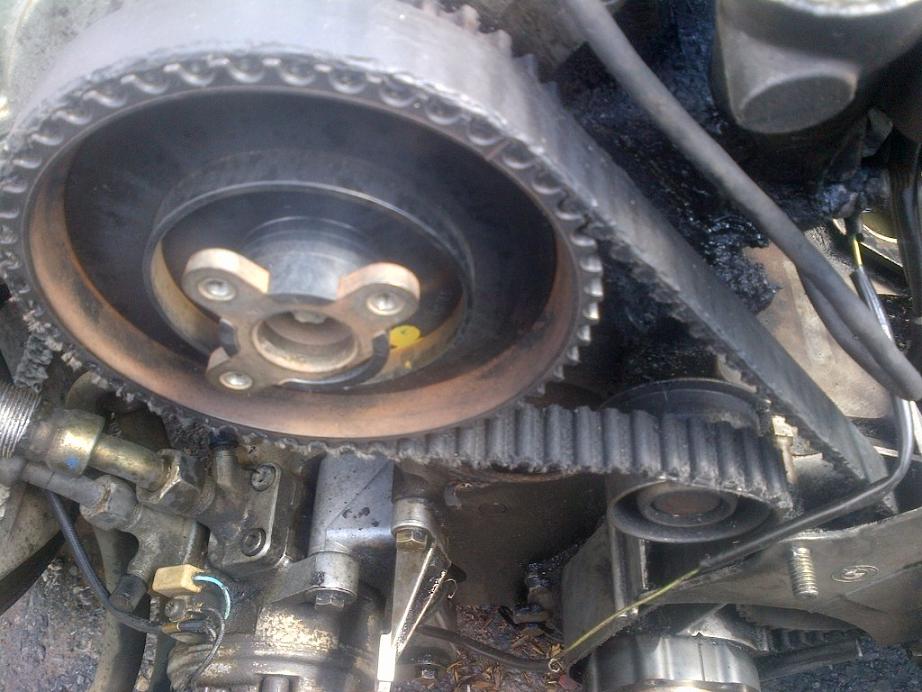

          If your TB is that old you MUST change it urgently along with the tensioner & spring. Its mileage OR age according to a senior Conti Engineer (and the rest of the world) so changing it would not be playing it safe...NOT changing it would be a potential disaster. The belt in that pic was dated 2002 and has very little mileage on it. You decide :p
          Perfect time to do the valves too but make sure you have a TB in place
