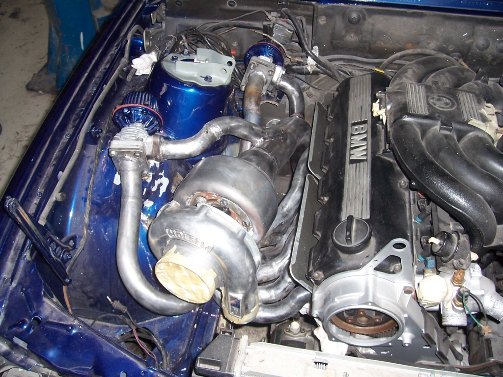

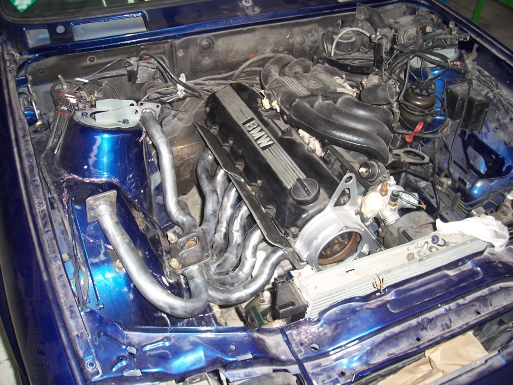

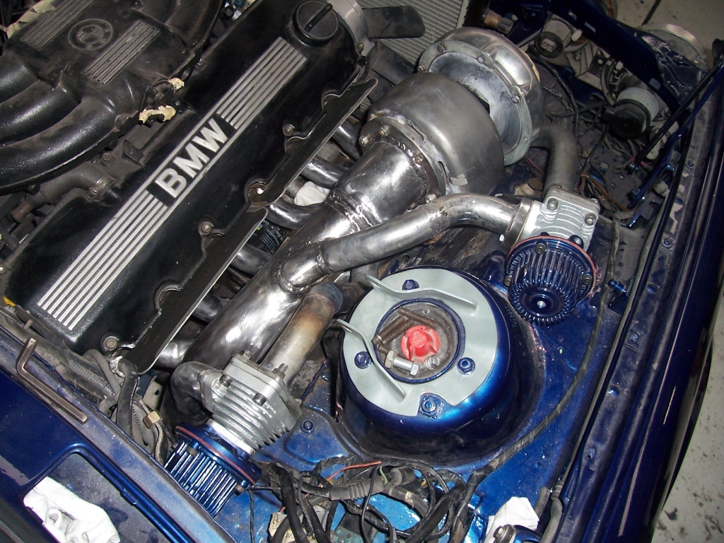

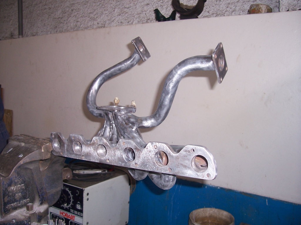

Well another update...I finished the turbo header finally and just need a coat oz zinc and some heat wrapp.
It's just a "test" fit after welding the whole pipes and fitted pretty good.
Next thing is to wrapp or cover some part of the shock tower and arround it with some aluminum sheet I have laying arround.
