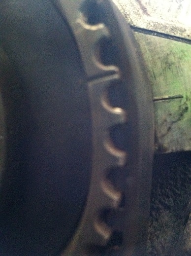

          o smoke tested the engine today and found that the only leak is in the iacv. i just swapped to another one and vehicle is still running bad. i just checked the timing and found it was retarted about half a tooth almost full tooth. i just moved it one tooth and now it sits just a cu*t hair advanced. didnt get to drive it really since i live like right around the corner but it doesn't feel to bad after i mooved that timing.

                Originally posted by ForcedFirebird
                It's not possible to be half a tooth off on the cam timing unless you had about .030" shaved off the head.
                It's weird it was sitting retarted not even a full tooth. It was like right at the base of the next tooth. When I moved it advance one tooth it was at the base of the timing mark tooth but advanced to the base of the tooth/valley I guess. Hard to explain. Cps is ok and jade been swapped out and problem still happens. Just drove it and it feels 80% better so I'm thinking the timing is the main part of my problem
                    It had to be the angle you were looking at it. It is physically impossible to be half a tooth off unless you significantly decrease the cam to crank centers (by shaving the block/head).
                    Yea I took a pic of it when I get to a computer I can put it up. The angle is straight on so maye this head has been shaved down in its past or something lol. Still getting a little bit of hesitation but not nearly as bad

                        that's as close to head on I could get with the camera ahaha but u can see I went from this and went advanced one tooth so no the cam sprocket line is where the other sprocket tooth is so just a hair past now
                        BmMmduBbB teChHh
                        • ForcedFirebird
                          • Feb 2007
                          • 8300
                          What are you using on the bottom to tell the crank is on time? Took the timing cover off and used the notch on the crank hub, or are you looking at the timing cover and line on the 6-2 toothed trigger wheel? The wheel has the timing mark 10 degrees BTDC.
                            that right there is using the snub on the crank with the block.

                              The only way you'd get that error, using the crank hub and notch on the lower timing cover is if the head has been decked to or below minimum. If at minimum, and adjustable cam sprocket or a modified cam sprocket with an eccentric bushing would be the fix. If below minimum a different head is the fix.

                                my head was shaved .010 and just a OEM HG , timing set at TDC from the block. Been beating on this set up one year now, not any timing related issues.
