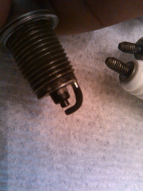

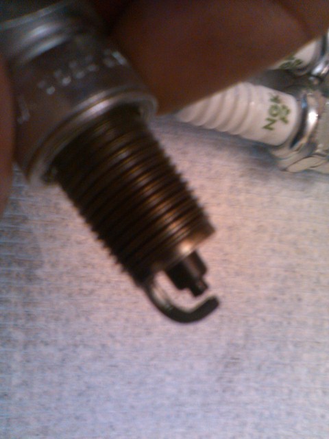

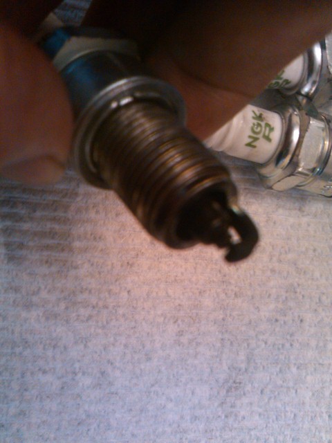

                        plug it in and i get no spark from the MSD, plug the old one back in and i get spark. I took the coil wire off the cap and tested. Still not starting and now my battery is draining. This is what my plugs look like, fouled/black and wet with gas. i guess i will do a compression test tomorrow.

                          The MSD must be bad. I used one for years in my old car.
                          Do you have the round injector harness under the intake manifold? Those are a common issue.

                            yes, but wouldn't that make the injectors stop working if the connector is not seated properly and or getting continuity? But my plugs are wet with gas.
