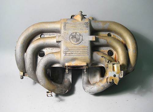

                    I cant post a pic right now, its raining and dark. I will ASAP. but it has this intake mainfold (see pic) with an 885 head. and the valve cover that says BMW on it with the three horziontal lines across it.

                      Congratulations, someone swapped your original engine out with one out of an 88 325 super eta. Does it say 2,5 on the fuel pressure regulator? Probably does....

                        it does! or would if the paint was there. so is it terminal doctor?

                          Yes, I'm afraid it is. Only thing left to do now is change the manifolds, cam and throw a turbo on it. Since compression is already 8.5:1, 10-20lbs of boost should alleviate the pain and suffering.
