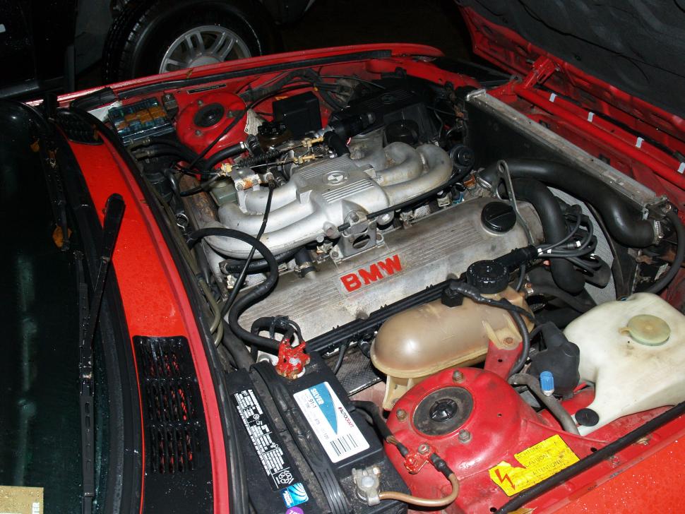

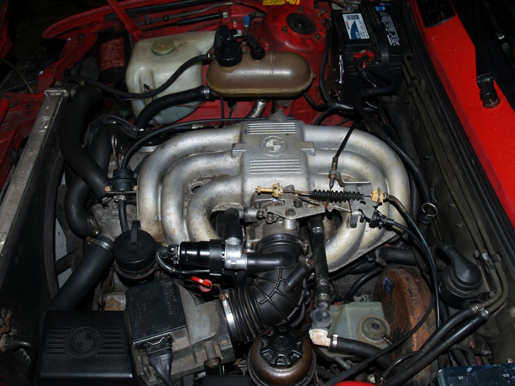

        Okay guys. Since being diagnosed i just need to know where its from.
        From these pics is it possible to determine a year? i know its a SETA now. Thanks guys.

          Well if it is a Super Eta engine (which it appears to be) they were in the 1988 325 only.
          It has the same head casting and valves as the i engines but a weaker cam and single valve springs.

              Alright guys reviving this thread cause i have some developments.
              the car used to be an i, that's a given. BUT WAIT THERE'S MORE.
              the block has these numbers on it 821 87. im not sure what it means!
              I have the toothed crank with the CPS on it and my AFM is from an i.
              So how can i know if there isnt just a different intake on it?? also what is the give-away for a throttle body to be from an i/super eta? i also dont want to open the valve cover!

                Look at the intake boot between the throttle body and AFM. If the throttle body end is smaller diameter than the AFM side, then it's a Super ETA throttle body (smaller version of the i throttle body). The regular ETA boot is completely different, BTW. Does your car have it's oil cooler installed?

                  yes it does have the cooler installed

                    Also just checked and body AFM and TB have same diameter and boot fits snug on both ends
