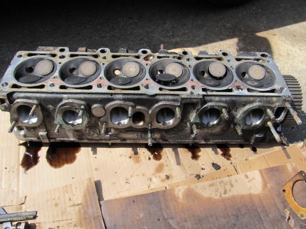

        i wouldn't use a welded head that cracked in the cam tunnel....
        if it was a regular Eta they could have put a SETA head ontop. The seta head is the same basic casting as an M20B25 (i.e the I and SETA head is marked xxxxx885 on the outside on the inlet side IIRC) but the cam, valve springs etc differ between SETA and M20B25

          3. How can I identify a standard E vs a super eta head from the exterior? Are there markings?
          If the head is from a SuperETA or M20B25 the casting number will end in 885.

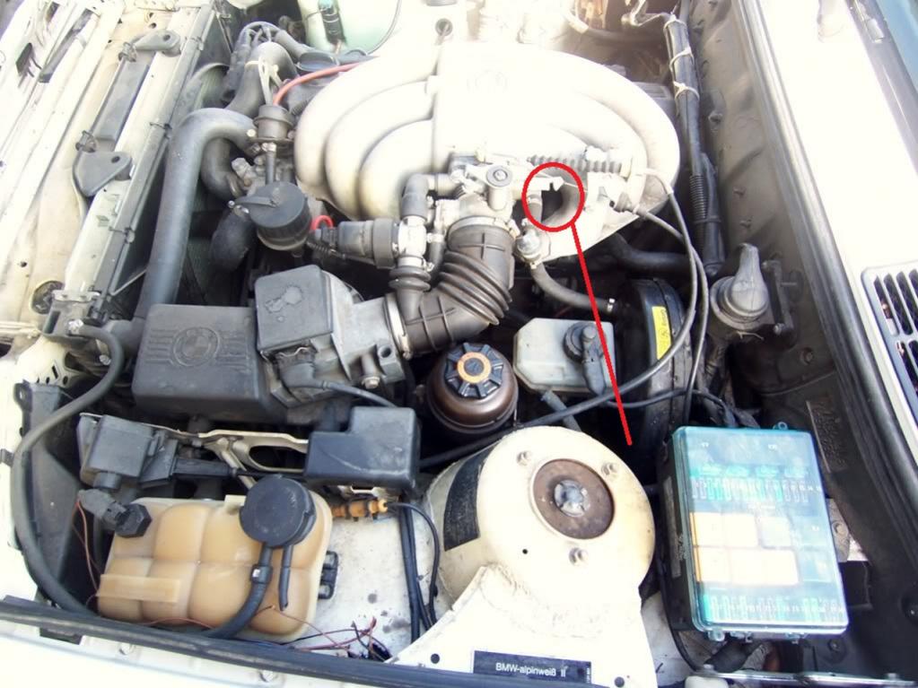

                Trying to decide whether to buy it for $1200 without pulling the thing apart first. But yeah, I need to see in there.
                Is this the only casting mark location? Is it hard to see under the intake runners?
                • EatsHondas
                  • Sep 2012
                  • 404
                  I have an "i," but if you look through the circled area from the same angle as the line going to it, you should be able to see "85". If you have a light and screw driver to poke a few lines out of the way, you should be able to see the entire "885" (or lack thereof) without removing any parts.
