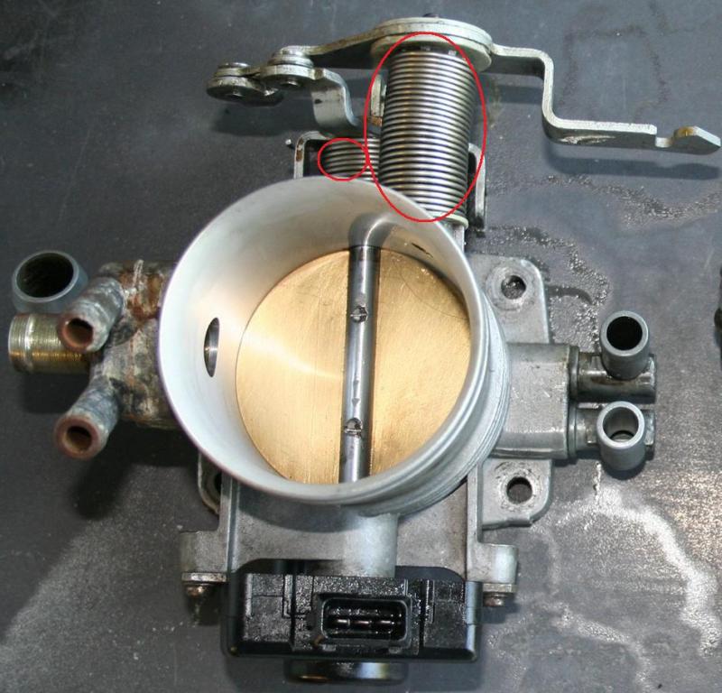

    If you recall, I found a vacuum leak a few months back in this thread: http://www.r3vlimited.com/board/showthread.php?t=286275
    Makes sense, it was a metal on metal connection with no press fit. JB Weld fixed that.
    Now after rigging a ghetto-fabulous smoke machine with a Swisher and a transfer pump, I've found two more leaks as indicated below. The smoke is literally emerging from in between the coils on BOTH return springs. RealOEM says that the throttle body is one solid piece and can't be disassembled. Are there seals/gaskets underneath both springs that can be replaced? I've read jlevie's comprehensive list of all possible vacuum leak locations and these leaks don't make the cut.
    There is a nut above both springs, but the linkage still doesn't want to come off (because it's connected to the butterfly inside the housing, yes?). Anyone else run into this before?

    There are no seals or replaceable parts in the throttle body. That leak is from wear and the only fix is replacement.

      I managed to get the linkage off and found tangible play in the throttle plate shaft. The cheapest new one I can find is about $353, is such an expensive vacuum leak even worth fixing? That's a lot of green for such a simple part...

        You should be able to obtain a good part for a lot less than that.
        Jim Levie, Huntsville, AL
        • ak-
          • 12422
          Buy used dude lol.
          Frankly you're the first I've heard to have a leak there so a good used replacement is out there.

            yea, I had the same exact problem, had a good used throttle assembly at my dor for $45, shipped

              I didn't want to buy used since I assumed all high mileage TB's would have this problem. I'll definitely look around, thanks guys.

                  That's what I'm doing now, I'm just gonna be pissed if the used one is worn out too.
