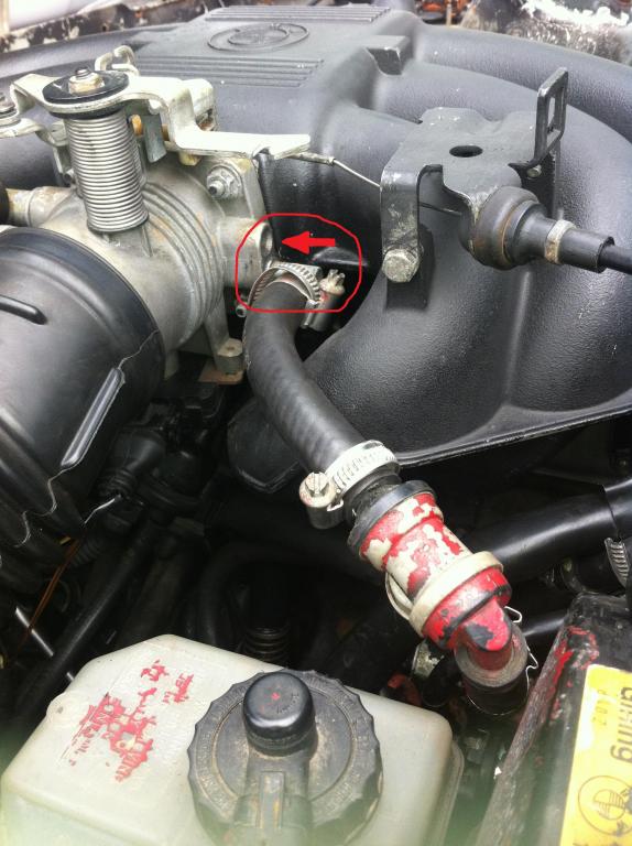

    Is this needed?
    So since im missing the little metal L shaped piece that goes where the arrow is pointing, I wondered If I can just PLUG it up and be ok? I still have the Power Brake Check Valve from the m42 engine, I know I have to switch to the one for the m20b25 but is it really necessary to do so? or can I keep current set up and plug that port like I mentioned? Its obviously creating a huge vacuum leak :(

    it should be plugged already in a late model car. i think

      Hmm idk real oem shows something diffirent, but my question etilo remains at the ok to plug? What does the power brake check valve do?

        I'm fairly certain the valve is only to retain as much power brakes as Possible in the event of the engine stalling.
          it is only plugged in late-model manual cars.
          fill the hole with JB weld and let it cure.

              Its not plugged on my late model and made it idle crazy when boost popped the hose off
